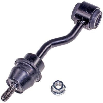

Comanche County Posted June 26, 2012 Posted June 26, 2012 96' to 98' is preferable. Be sure to get the rotational sway bar links also. They're much better than the straight stud XJ style. The straight stud style will eventually bend and break. The ZJ swivel links are better for longevity.
HOrnbrod Posted June 26, 2012 Posted June 26, 2012 96' to 98' is preferable. Be sure to get the rotational sway bar links also. They're much better than the straight stud XJ style. The straight stud style will eventually bend and break. The ZJ swivel links are better for longevity. Never heard of this Jay. :hmm: Do they mount the same and are they the same length? Got a pic? Any of you guys ever install one on the rear? Didn't install it, but had an aftermarket Addco MJ rear swaybar. Because of the shock absorber mount difference between the LWB and SWB, it wouldn't fit my LWB. Fits the SWB MJ just fine though. This is the only one I know of that is still available. http://www.andysautosport.com/jeep/1984_1992_comanche/suspension/sway_bars/addco/addc00097023.html
mvusse Posted June 26, 2012 Posted June 26, 2012 ZJ (and TJ I believe) and probably some others use a tie rod end sort of end on top instead of rubber bushings. They do not fit correctly on an MJ/XJ sway bar, but could work, somewhat. I say use the links with the bar they were designed for. On a stock rig with the loner (newer) links I have never seen one bend or break, just on lifted rigs or using the older short links. Problem I have is that they break when twisting the top nut to remove them, or they rot away to nothing between the bushings.
HOrnbrod Posted June 26, 2012 Posted June 26, 2012 ZJ (and TJ I believe) and probably some others use a tie rod end sort of end on top instead of rubber bushings. They do not fit correctly on an MJ/XJ sway bar, but could work, somewhat. I say use the links with the bar they were designed for. On a stock rig with the loner (newer) links I have never seen one bend or break, just on lifted rigs or using the older short links. Problem I have is that they break when twisting the top nut to remove them, or they rot away to nothing between the bushings. Here's a pic of one for a 97 ZJ from the Autozone web site. Doesn't look like it will fit correctly.

gogmorgo Posted August 30, 2018 Posted August 30, 2018 Ooooooold thread. When end put the ZJ sway bar on my MJ, I just used a minty set of XJ end links from the same yard. They've been on there about 20,000 miles with no issues. I don't really remember why not, but the ZJ links didn't look like they'd fit. That or they weren't in very good shape... or else the minty XJ ones were just almost new. It was a few years ago now.
rynoshark Posted August 30, 2018 Posted August 30, 2018 Interesting...end links with new rubber are so cheap now ($17 for a pair of ZJ sway bar end links). It seems like it just makes sense to order new.
