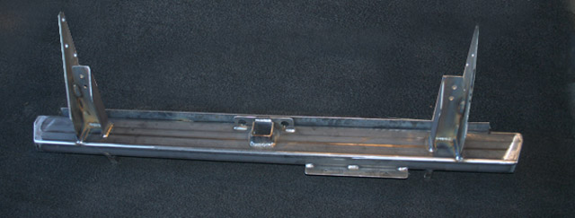

jpnjim Posted February 5, 2010 Share Posted February 5, 2010 I don't know what JCR rates their rear bumper to tow: http://www.jcroffroad.com/Merchant2/mer ... y_Code=MJB but (in my completely worthless, nonbinding, unofficial opinion), it looks atleast beefy as the 500/5000lb U-haul hitch I just got. + JCR is a member here, so you'd be supporting someone who supports us. :cheers: (tho you did just miss a great sale on this bumper, it was cheaper than the U-haul hitch a couple weeks ago :eek: ) Link to comment Share on other sites More sharing options...
AMC-MJ Posted February 5, 2010 Author Share Posted February 5, 2010 :mad: $325 :fs1: . . . :rotfl2: Not happening on my income :thumbsup: Mike Link to comment Share on other sites More sharing options...
JACKED88 Posted February 5, 2010 Share Posted February 5, 2010 Stock MJ rear bumpers suck for towing. Do not buy one of those little receiver hitches that bolt up to tha bottom side of your bumper unless you intend to weld your bumper brackets to tha frame. Without welding, the 4 bolts that hold your bumper on will not keep tha bumper from twisting downward. Especially true if you have a lift and run a drop receiver. The additional leverage of a drop receiver increases the twisting effect. I tried and you can not tighten those 4 small bolts that hold the bumper on tight enough to stop this from happening. You will likely end up twisting you bumper to a point that tha bolts shear off resulting in your bumper coming off your truck. At that point your bumper and trailer will be on their own and likely headed for the other lane on into tha nearest ditch. Either way it won't be pretty. Welding or a frame mounted hitch is your only safe option. As you can see in these pix, my bumper is twisted downward a little. Since then I've lift it back into place and put a couple of tack welds on tha bumper brackets. I had to be able to pull my trailer and atv so I did what I had to do. I'll build a receiver hutch later but for now this is working OK. I do however keep tha trailer and tongue weight to a minimum and try not to hit tha brakes very hard. Did I mention how much I hate tha frickin dent in my bumper??? :( Looks like crap!!! Link to comment Share on other sites More sharing options...

jpnjim Posted February 6, 2010 Share Posted February 6, 2010 :mad: $325 :fs1: . . . :rotfl2: Not happening on my income :thumbsup: Mike You can get a 350/3500lb Black Westin/FEY Bumper (pn63000) for $117 with free shipping here: http://www.amazon.com/Westin-63000-Fey- ... sim_auto_1 but figure $40-50 for the MJ mounting brackets (pn97900): http://www.summitracing.com/parts/TUF-97900 http://cgi.ebay.com/ebaymotors/FEY-BUMP ... 20aedeeac7 Link to comment Share on other sites More sharing options...
