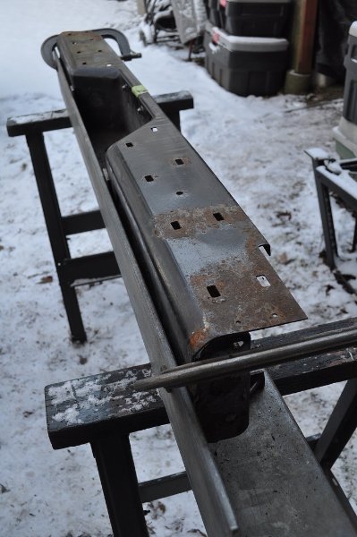

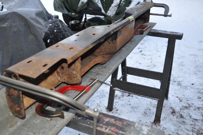

Sorry, I just saw this. That looks great! I had the impression that the hitch hung a bit lower. I appreciate your offer but I've almost finished fabricating my hitch. I removed a Westin-Fey bumper which had what I think are the right bumper mounts for it. I've only seen pics of them and of the OEM mounts for my short bed. I modified what I have (basically boxed them) to add some strength and mounted an OEM bumper to them. I made 1/4" plate brackets to attach a cross tube that bolts to the 2" receiver that I previously had on the W-F bumper.
When looking into the W-F bumper on e-trailer.com I was surprised to see that it is rated for 3,500 lbs. If I didn't want to convert to an OEM bumper I would have been fine with the W-F bumper.
Sorry, no pics yet but I'm confident it will tow my tear drop (1,500 lbs.) and expedition trailer (about 800 lbs.) with no problems.
The only pics I have so far are of what I started with and of my "bumper straightening machine" lol. Lots of sand blasting, refinishing and painting to do yet, but at least it's straight!
