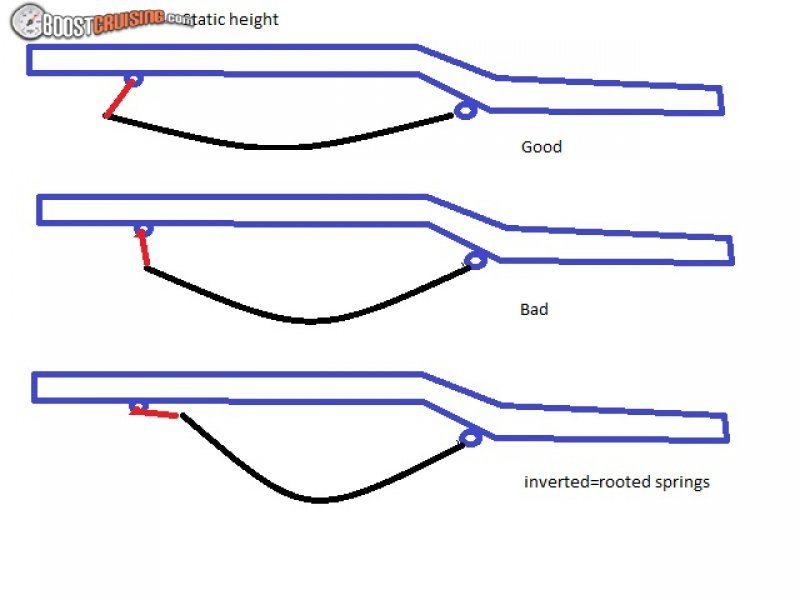

Right but they didn't fold towards the front after you lowered the truck off the jack? Here is a better picture to explain what I'm talking about. https://goo.gl/images/g33NkQ You sure they are MJ leafs and not XJ leafs? They are different sizes and often XJ parts are sold as MJ even though they aren't the same. What is the measurement from eye to eye straight across? XJs are 51.5" across and MJs are 57" -
Post lift tire location problem
Dzimm replied to Gubachoo's topic in MJ Tech: Modification and Repairs
They aren't inverted are they? They should fold towards the rear of the truck. https://goo.gl/images/BXWu7G -
Do you have all the trucks weight on it? It definitely shouldn't be that far forward. You sure you didn't put the leafs on backwards? IIRC the larger end should go toward the front in the body mount, and the smaller end in the shackle. Here is mine after a 4.5" Rusty's kit. Sits right in the middle. -
