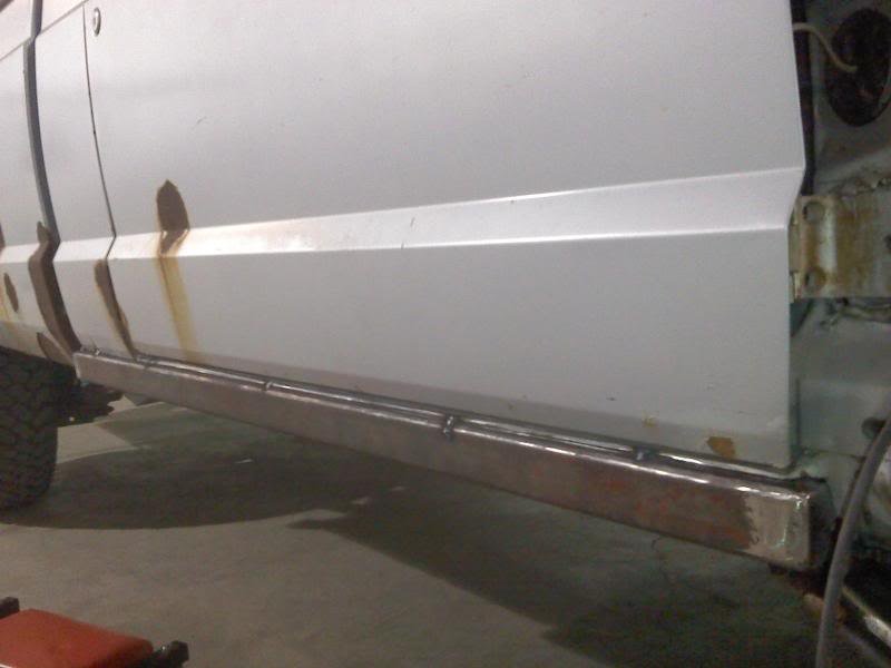

  16. The 2x4 was free, scrap metal from an old International Harvester cultivator. YellaHeep's experience and recommendation with ice/snow accumulation on the 2x6 also guided my choice. Now that I have seen the 2x4 in place, I am glad I did not go with 2x6 since the 2x4 is more inconspicuous tucked near the body.
  17. Not at all. 5 more minutes with your preferred metal cutting tool and the front chunk would be gone. All of the XJ guys I have seen do this have taken the box to the wheel well for complete coverage, which makes sense if you are going to be playing in the rocks.
  18. Made a little progress on the rocker replacement: You will notice I opted to maintain a portion of the stock rocker up front hidden behind the front fender). I did this because the truck isn't a hardcore wheeler and it will provide strength to keep the 2x4 box from twisting should it come in contact with something.
