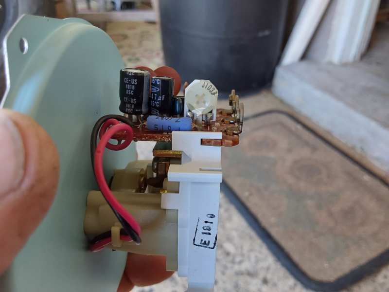

Pete M Posted 9 hours ago Posted 9 hours ago the tach will likely be off. but I can't remember which years might be adjustable.
Jeeper1093 Posted 9 hours ago Author Posted 9 hours ago Thank you for the info guys! Much appreciated. I am planning on swapping both the cluster and cable so hopefully I will be good. I have a feeling that my tach is not adjustable but I will see
Jeeper1093 Posted 8 hours ago Author Posted 8 hours ago 😆 😆 🤣 Got it! Thanks for the help. From what I've read I need to turn it all the way to the left correct?
