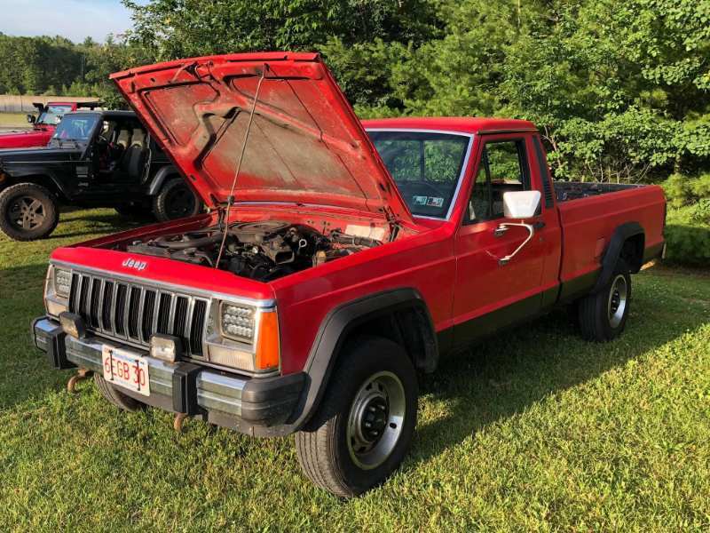

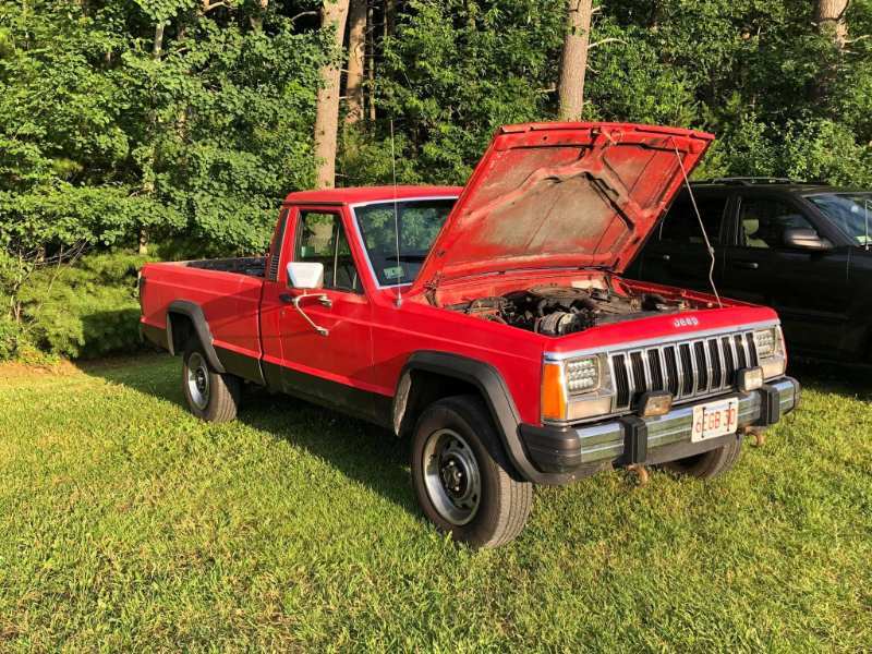

Best story I have is of my truck, the day I went to pick her up.
I had been perusing marketplace for a Comanche for a while, not quite finding what I was looking for. Something that needed some work but I could drive home. I am in Massachusetts, went up north to new Hampshire to look at one that was.. rough. And needed a clutch. Can't remember what he was asking. It was an 88 or 89 4.0 5 speed short bed, can't remember if 2x or 4x. So I took photos and told the guy id have to think on it. Posted up the photos to the MJ Facebook group asking if I should buy it, a lot of nos and a few yeses. And one particular comment from a woman who said "why not buy my truck instead?" So for a few weeks we got to chatting on messenger, of her telling me all about this truck that her parents had bought brand new in 86 and how it was her childhood, and eventually her first vehicle, and then her children's first vehicle and then it got parked up. And sat as an extra truck that wasn't getting used. So we made plans, and I convinced my best friend to come along aaalll the way to Pensylvania, in the Poconos to get this truck, over 5 hours one way. And we didn't realize we planned this on.. mother's day. So what went from a weekend trip, staying the night at some family member who lives out there as well to a single day trip! Just to get back for mothers day haha
And we did it! All I had seen were photos of the truck and word that it ran, took one of my spare cars some tools and fluids and my best friend and I drove out!
Upon arrival we were greeted by the WHOLE family, wanting to say goodbye to the truck and see who the new owner was. The whole family was super nice and welcoming. The original owner, the grandfather of the family was an air force vet, with a specialty in fiberglass. Spent his time restoring 70s vettes. And the MJ. Some of his approaches were.. unique for the MJ, but not bad. Anyway, we spent some time with the og owners daughter who shuttled us around to help us get the title motorized and a temp plate printed. Its a pain in pa FYI lol after a few hours of struggling success was had, title transferred and a temp plate made so I could drive her home! Loaded up my tools and fluids, said out many thanks and goodbyes, the og owner shook my hand and said "I can't believe you are driving this thing home.." but that's what makes for great stories, right? Hopped in the truck, fueled up both vehicles and hit the road. A little over 5 hours later we were home and tired hitting the driveway at 2am.. but super happy the truck made that drive without a single hiccup.
I still talk to the woman that sold me the truck, we are friends on Facebook and she loves to see updates when I post them.

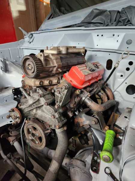

For those who missed it, dry fit!
