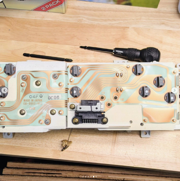

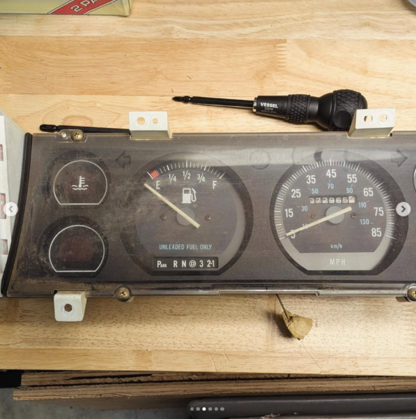

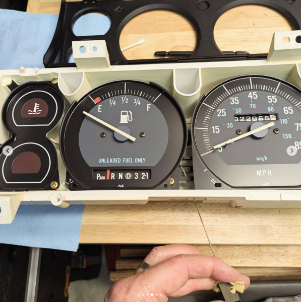

Made in Japan! With the Comanche lower dash and bezel removed I investigated why, how, what tha heck is going wrong with my column shift indicator needle being broke for the past 7 yrs. Turns out it was there and hiding the whole time. It operates with a wire connected to the column shroud. The column shroud is broke and wouldn't turn when the shifter rotates to the different gears. Those details and my fix for that is coming soon. The instrument cluster is very cool! But, We have some issues with that too. Gas gauge shows empty, speedometer also doesn't work. I wanted to see if there was corrosion or something obvious on the rear circuit panel but it all looks really good. I might have to pick the brain of some of you Comanche and Cherokee experts!

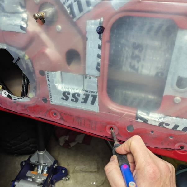

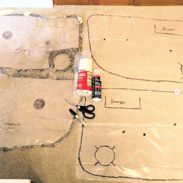

With the doors on the Comanche disassembled, I've finished installing the speakers and routed wiring. Created brand new vapor barriers by tracing the originals onto simple 3mil plastic sheeting. Used 3M Super 77 spray adhesive to lightly attach. Then I used my cheapo soldering iron to melt the fastener holes. It worked perfect!

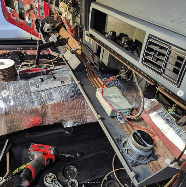

I have a lot going on with the Jeep truck, several open projects are getting worked on at the same time. I have the lower dash, instrument panel and doors all opened up right now. This is a cool part here, I'm installing door speakers. The truck did not come with speakers or wiring for the doors. The speaker bracket is already built into the door. I needed to cut through the door panels. Many folks have done this before on Jeep XJs and Comanches. One thing I noticed was that the padded door panels get compressed and almost wrinkled because the door speaker bracket is inset and the speaker has to mount from the outside of the panel. As you tighten the mounting screws it drags and compresses the vinyl and padding into the inset. To prevent this small detail I wanted to create a spacer of sort. The inset is about 5-6mm deep. I was looking for all kinds of options, dense rubber sheet, wood and other options. I found a sheet of hardboard I had in the garage. It was 2.5mm thick. I made a template and cut out two pieces and glued them together making a perfect 5mm spacer. I spent way too much time in this little project but it ended up working out just right. I then cut out the speaker hole in the door panel, carefully, layer by layer. I glued the new spacer in place and set some sand bags on it overnight to dry and stay tight. More details to come as I keep making progress on these interior projects!
The Comanche is getting an upgrade! I'm not an audio expert at all, but the original truck only came with two tweeters under the dash. It's going to take some work to get all the brand new wiring mapped out and ran through the doors and to the rear pillars. Digging into it!

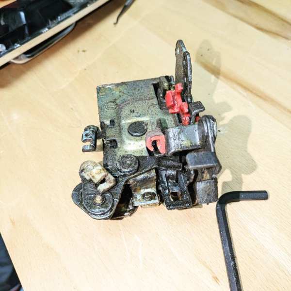

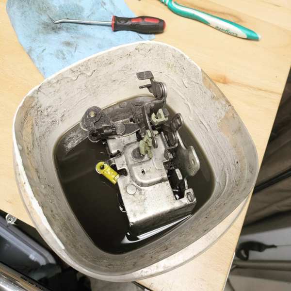

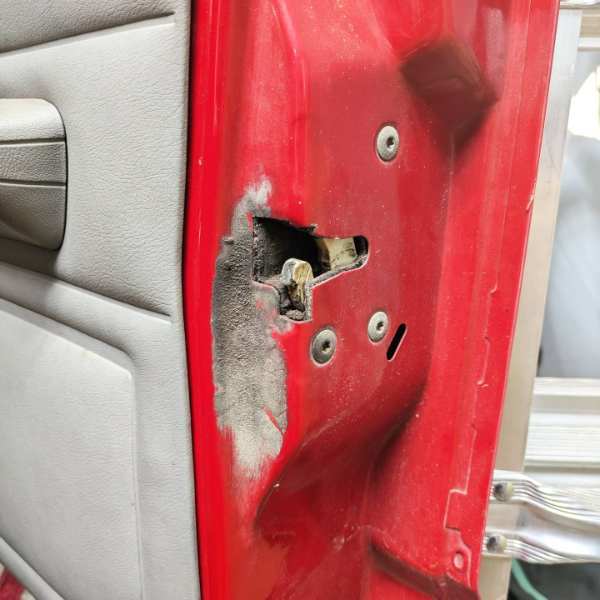

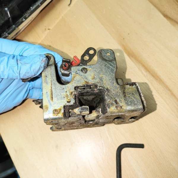

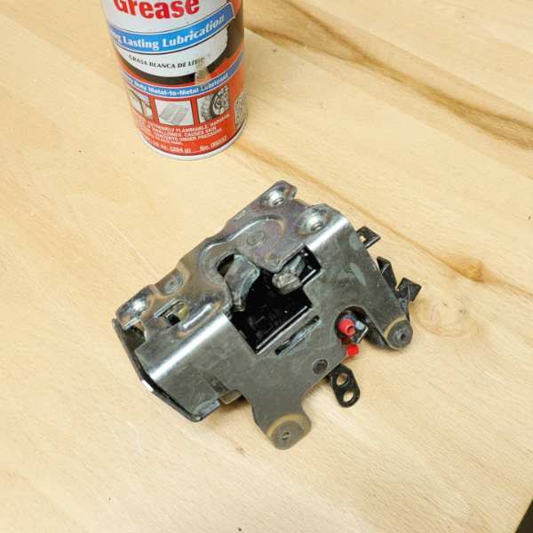

A maintenance item that had never been addressed was cleaning and lubricating the door latches. They were gunked with mega hardened 35+ year old grease and grime and whatever else the previous owner sprayed in there. I disassembled the door, removed the latches and soaked in mineral spirits for about an hour. Most of the junk softened and I could brush out with a toothbrush and the hard stuff with a pick. Got it lubed up with some lithium grease and it's working supa smooth!

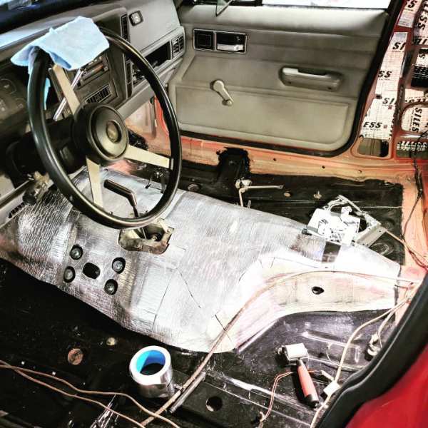

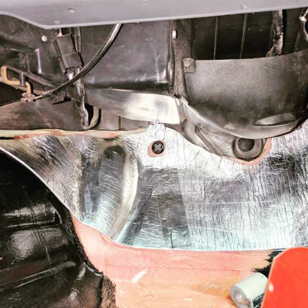

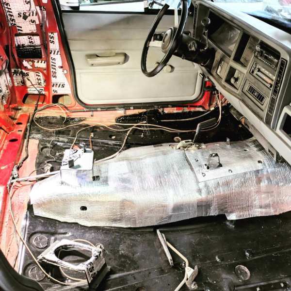

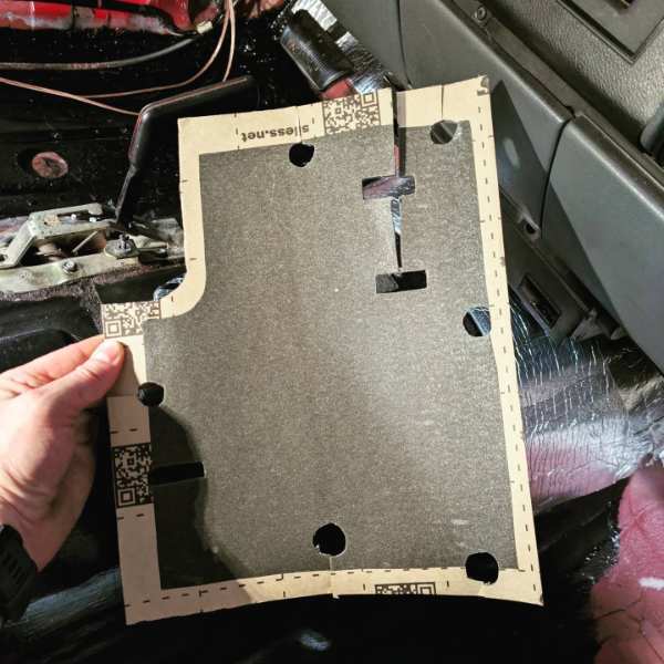

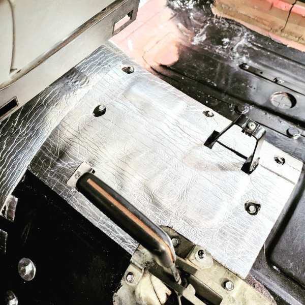

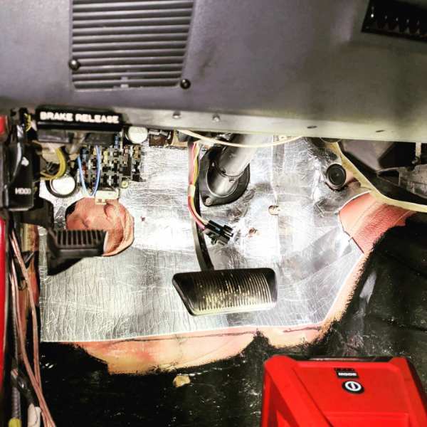

Had a chance to work on the Comanche over the last few weeks. I had previously cut out the decayed heat barrier from the floor pans and firewall. Here, I custom cut and fit sound deadening butyl and closed cell foam heat barrier. The passenger side and transmission tunnel took me about 2 hours, the driver's side took about 3 years since my last post! Haha I used Silass for the sound deadening and heat reduction and aluminum tape for all the seams except the cover on the trans tunnel
