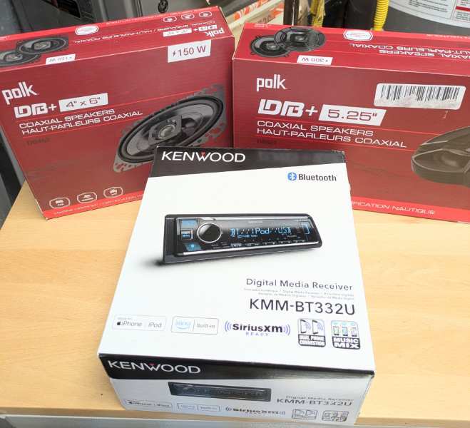

I have a lot going on with the Jeep truck, several open projects are getting worked on at the same time. I have the lower dash, instrument panel and doors all opened up right now. This is a cool part here, I'm installing door speakers. The truck did not come with speakers or wiring for the doors. The speaker bracket is already built into the door. I needed to cut through the door panels. Many folks have done this before on Jeep XJs and Comanches. One thing I noticed was that the padded door panels get compressed and almost wrinkled because the door speaker bracket is inset and the speaker has to mount from the outside of the panel. As you tighten the mounting screws it drags and compresses the vinyl and padding into the inset. To prevent this small detail I wanted to create a spacer of sort. The inset is about 5-6mm deep. I was looking for all kinds of options, dense rubber sheet, wood and other options. I found a sheet of hardboard I had in the garage. It was 2.5mm thick. I made a template and cut out two pieces and glued them together making a perfect 5mm spacer. I spent way too much time in this little project but it ended up working out just right. I then cut out the speaker hole in the door panel, carefully, layer by layer. I glued the new spacer in place and set some sand bags on it overnight to dry and stay tight. More details to come as I keep making progress on these interior projects!
The Comanche is getting an upgrade! I'm not an audio expert at all, but the original truck only came with two tweeters under the dash. It's going to take some work to get all the brand new wiring mapped out and ran through the doors and to the rear pillars. Digging into it!
