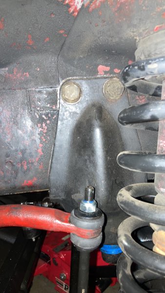

eaglescout526 Posted September 10, 2025 Author Share Posted September 10, 2025 tracking my findings here. 9/9/25 One nut found out of torque spec-pitman arm to linkage tie rod Found track bar bracket to frame bolts loose, loose enough to spin but not come undone thanks to years of oil and rust. Now torqued to spec. Found an outline of the bracket having possibly moved each and every time when I turned. Probably resulting in my steering clocking issue. 9/10 Found both ends of the track bar hard ware not torqued to spec 9/11 Everything within spec on the pass side. I think that bracket has been my problem for some time. This would make sense for both my clocking after turns and getting DW to trigger on the drivers side. Thinking about the 3 times it happened, the wobble and vibrations were felt more in the frame than the steering. I have yet to take a drive but will soon and will drive to the spots where I got DW to trigger. Never would I have ever thought about that bracket. Arent these typically stuck and rusted in place? Haha. Link to comment Share on other sites More sharing options...

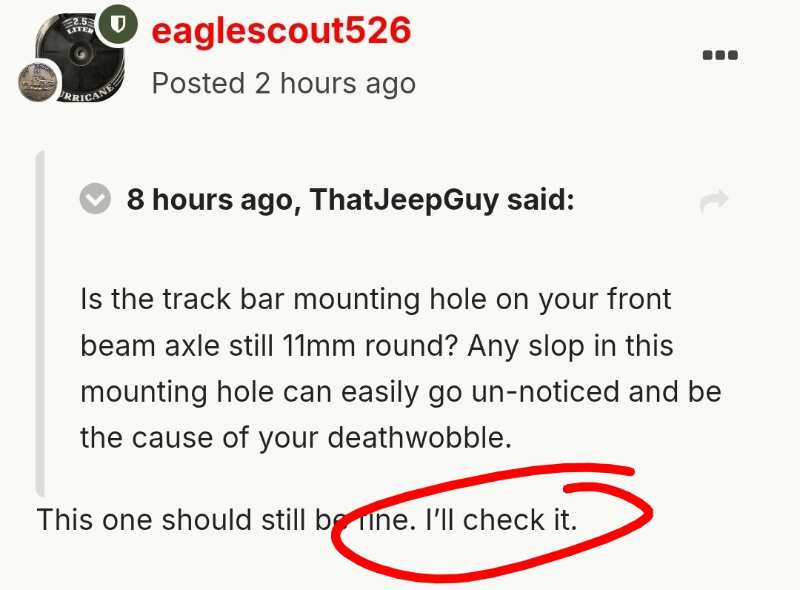

ThatJeepGuy Posted September 15, 2025 Share Posted September 15, 2025 16 hours ago, eaglescout526 said: I'm looking at 3 ideas, track bar is just garbage along with the mounting hole. For the love of goddess would you check this already!? With the pictures you posted of your frame side bracket bolts being sloppy - it doesn't take much if the axle side bolt was lose as well to have an egged out hole. Link to comment Share on other sites More sharing options...

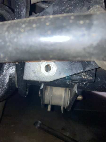

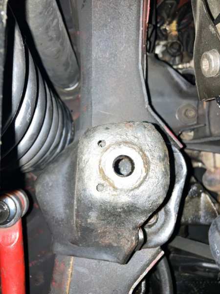

eaglescout526 Posted September 16, 2025 Author Share Posted September 16, 2025 14 hours ago, ThatJeepGuy said: For the love of goddess would you check this already! Process of elimination mi amigo! How ever I found exactly what I was going to expect when I removed the track bar. Bad pic alignment on the axle but they’re both completely round and as they should. Now I’d be damn impressed if the hole for the frame mount wallowed out. That that is some thick iron. How ever. Two things. One the tie rod for the track bar is rather loose. Compared to the old mopar bar still laying around, it’s really loose. The mopar bar requires some effort to move the tie rod. Another concern is the bolt thickness at the axle. Is a slight wiggle ok there? I feel like it is but I’d imagine the bolt is supposed to fit snug in the axle side. This is with the bolt in the bushing not the axle. Though there is some wiggle there but that goes away as your torque it down. Link to comment Share on other sites More sharing options...
A-man930 Posted September 16, 2025 Share Posted September 16, 2025 Visual inspection looks good. Does the bolt look worn out? However, wiggling joints with your hands is next to pointless unless the joint is totally trashed. Get a partner to cycle the wheel back and forth with the weight on the tires. Observe and feel each joint in the entirety of the suspension and steering. It takes 5 minutes. Link to comment Share on other sites More sharing options...
