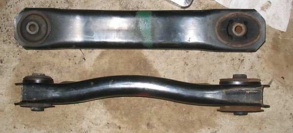

i know the wj arms are solid arms and do allow for more turning clearance turning but you do have to grind the bushings down to make them fit.you seem to be on the struggle bus at times so i would just go with the stock arms and keep it simple.yes,most of the detroit axle stuff is crap.it either doesnt last long or simply doesnt fit.its one of these things that you get what you pay for.

it only takes a couple minutes to mod the WJ arms.  just need to trim the steel bushing flush with the rubber bushing.  :L:   you can see in the pics where it protrudes like a 1/4".
Ok, Pete. I can see you're all-in on this swap. Question: I run stock size tires. Is there any benefit for me from this mod?
On 6/16/2025 at 8:54 PM, Pete M said:
superior bushing design and superior arm design for a better ride. :L:

Ok. That sounds like it's worth looking into. What's the model year I need to reference for the WJ?

99-2004 were the main years for the WJ
