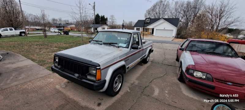

So I dug into the camper much deeper last Saturday. Got the canvas fully pulled off so I can remove the bad sections and make templates to recreate them. Got some swatches in to try and color match and surprisingly the natural canvas is the closest color match. I might try to use some RIT dye to match, not sure yet.
And I'm still perplexed by the roof. I donned my respirator and started pulling the ceiling off. The whole thing is moldy. It very much seems like the Styrofoam is just glued to the aluminum roof skin. I had to jam my scraper in between the foam and whatever it's glued to rather hard just to get this little bit off. Also, the foam is completely soaked in water. Judging by the surface area and how much water comes out I think it probably adds about 75 lbs to the camper :laugh:
Also pulled the veneers off to get an idea of how the lower "walls" were built. Seems like 1/8" ply with what was advertised as a distressed elm veneer. The outside seems to just be 1/4" ply. Elm is nigh impossible to get in a typical lumber store but I've found a very small husband and wife team that sells specialty veneers for very reasonable prices so I can keep the interior in the red elm it originally came with.
