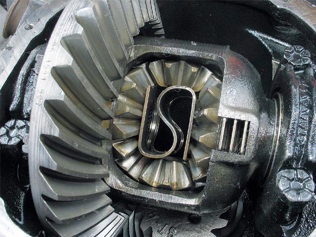

AZJeff Posted June 2, 2023 Share Posted June 2, 2023 I guess I learned something new. I always assumed the normal LSD looked something like the attached photo inside. I guess I was wrong, and there is more than one way to make an LSD, and some of them don't show the clutch packs so obviously. Link to comment Share on other sites More sharing options...
jpnjake Posted June 2, 2023 Share Posted June 2, 2023 Here’s what my xj 44 with factory lsd looks like you can see the clutches hiding just behind the spiders Link to comment Share on other sites More sharing options...
AZJeff Posted June 3, 2023 Share Posted June 3, 2023 1 hour ago, jpnjake said: Here’s what my xj 44 with factory lsd looks like you can see the clutches hiding just behind the spiders That's what I am used to seeing. I guess just because a diff. has LSD does NOT mean it will look like all other diffs with LSD. Everybody who makes an LSD carrier does them a little differently. Link to comment Share on other sites More sharing options...
