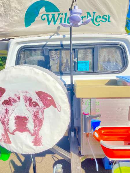

fiatslug87 Posted November 11, 2024 Author Share Posted November 11, 2024 Got back from camping, one night we had constant 45mph winds, had to take down the WilderNest and sleep in the closed up camper. But here is the shower at work, the dogs loved it. Link to comment Share on other sites More sharing options...
89 MJ Posted November 11, 2024 Share Posted November 11, 2024 That looks like it worked pretty darn well. Real good water pressure. Any changes that you want to make now that you’ve slept in it with the WilderNest down? Or was the room good enough? Link to comment Share on other sites More sharing options...
fiatslug87 Posted November 11, 2024 Author Share Posted November 11, 2024 It was very cramped with the WilderNest down. My wife slept on the truck bed (on the mattress) with one dog and I slept on the drawer (foam pad) with the other dog. There isn’t much headroom on top of the drawer but it is what it is. The only change I would make is keeping stuff a little more organized making the move down quicker. Link to comment Share on other sites More sharing options...

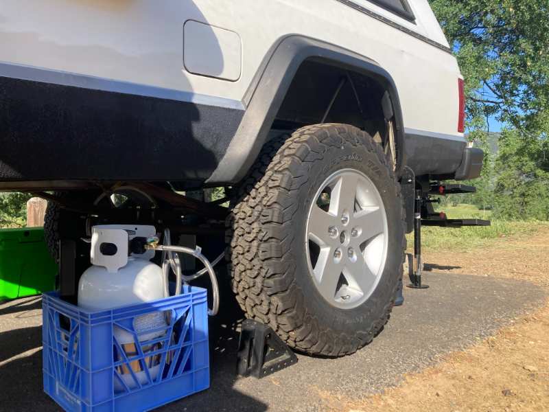

fiatslug87 Posted February 6 Author Share Posted February 6 I replaced the bumper mounted hitch receiver with a Draw-Tite MJ hitch, it was too unstable/wobbly feeling. I flap disked it to bare metal, gave it two coats of Por-15 and two coats of Rust-Oleum satin black. Used 1-1/2” inch zinc plated perforated square tube as spacers and bolted it to the WilderNest. The support jacks will now use the hitch. Also got a dual hitch extender so I could offset a foldable step (think I need to extend it to the left a little more) for entry into the WilderNest which folds up for travel. Link to comment Share on other sites More sharing options...

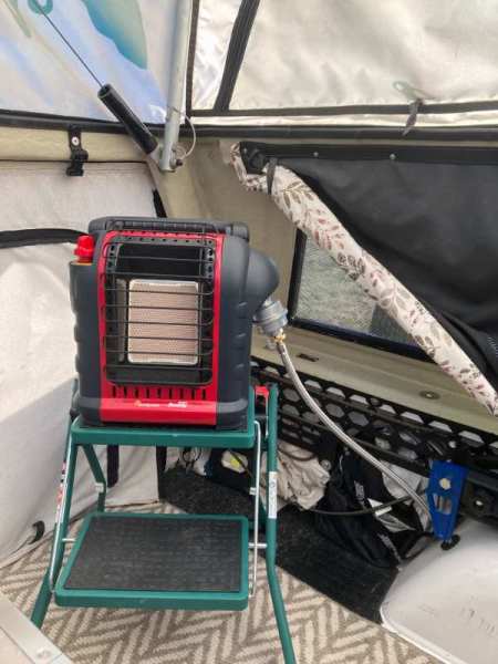

fiatslug87 Posted February 25 Author Share Posted February 25 We’re at New Hogan Lake in Calaveras County, CA. Lots of loud geese out here, gives the dogs something to chase. The step is working out great for both dogs and humans. Got a little Mr. Heater Portable Buddy heater to lessen the morning chill in the WilderNest, runs on propane. Weather is nice, 70° and blue skies. Link to comment Share on other sites More sharing options...
