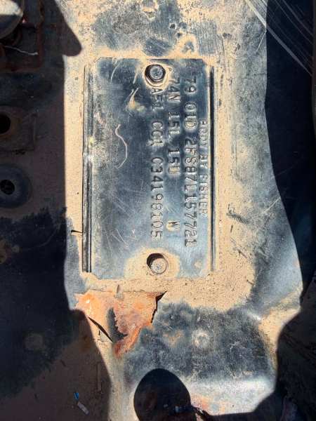

First post has been updated with pics. It may look rough but that’s just the interior and body. Quite honestly it’s mostly surface rust. Took a while to get the hood to actually open but once I figured it out, lubed the hell out of the latch and hinges it now opens pretty freely.
The good, it’s all there, top of the line 10th anniversary firebird in a one year only ext/int combo.
The bad, engine has a possibility of being stuck, carb is stuck, drivers side door handle is broken, front fascia is warped, rear fascia is wayyy worse than the front annnnd interior is crumpling. And this is from the same backyard I got my MJ from! And this car has sat a bit longer than my MJ!!!
