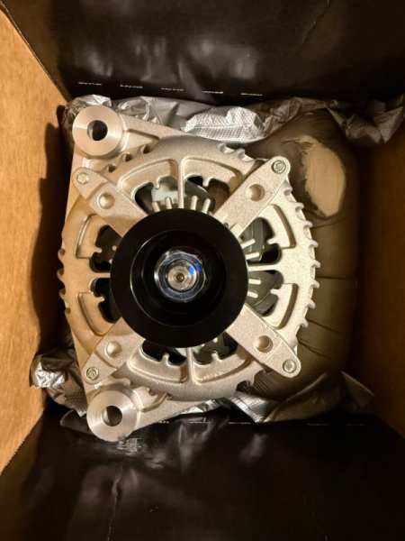

ghetdjc320 Posted July 26 Author Posted July 26 Ordered up a Mechman alternator. My existing alternator was original to the engine and the regulator was staring to have issues. The mechman amperage at idle is excellent. The goal is to keep alternator voltage at idle vs dipping into battery reserve.
A-man930 Posted July 27 Posted July 27 On 7/25/2026 at 8:31 PM, ghetdjc320 said: Ordered up a Mechman alternator. My existing alternator was original to the engine and the regulator was staring to have issues. The mechman amperage at idle is excellent. The goal is to keep alternator voltage at idle vs dipping into battery reserve. That'll be a nice addition. Only thing that worries me about a special part like this is the availability... I guess a stock one would work in a pinch.
ghetdjc320 Posted July 28 Author Posted July 28 On 7/27/2026 at 6:17 AM, A-man930 said: That'll be a nice addition. Only thing that worries me about a special part like this is the availability... I guess a stock one would work in a pinch. That’s right. Since the case and connections are the same, a parts store alternator would work in a pinch. These mechmans are really nice units. High quality bearings and square copper windings.

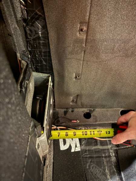

ghetdjc320 Posted July 28 Author Posted July 28 Audio system under construction at the moment. I’ve long wanted to build enclosures for some compact subs in the b pillars. It’s really an ideal location for them if done right. Started by some careful measuring the other day. Plan is custom enclosures for (2) JL 6.5 W3 subs. Will feed them with either a 3 or 4 channel amp from a customized RX173 head unit with a DSP.

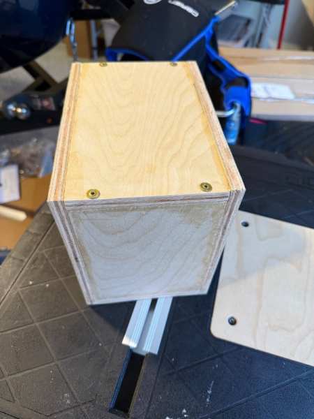

ghetdjc320 Posted July 29 Author Posted July 29 Here’s the beginning of this project. 1/2” birch for the shell which is appropriate for the JL 6.5 subs. Exact dimension tbd but I’m within a narrow range. QTC will be in the .75 range

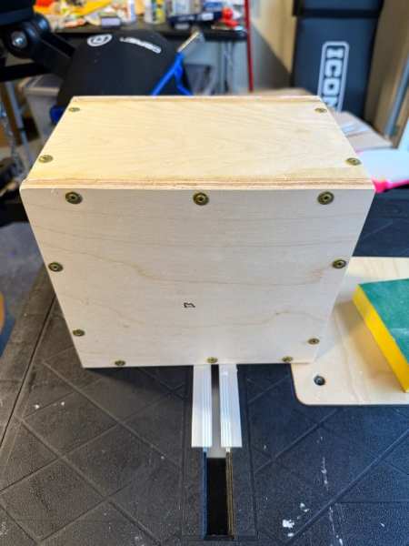

ghetdjc320 Posted August 7 Author Posted August 7 All the glue is dry now. Going to put in some seam sealer around the inside just for the xtra insurance. For reference, I used 1/2” birch, wood glue, 1.25” cabinet screws and polyfill. Will probably finish them with some black textured bedliner. Next, I’ll cutout the b pillars and measure out the cabinet/edge supports
ghetdjc320 Posted August 11 Author Posted August 11 Overall dimensions are 9w 8h and 6.25d giving .17 airspace with 1/2 birch. Driver displacement of .02 give us a final of .15 and right in the money. Added 40% polyfill to dampen the response a bit. Some update pics of the finished product:

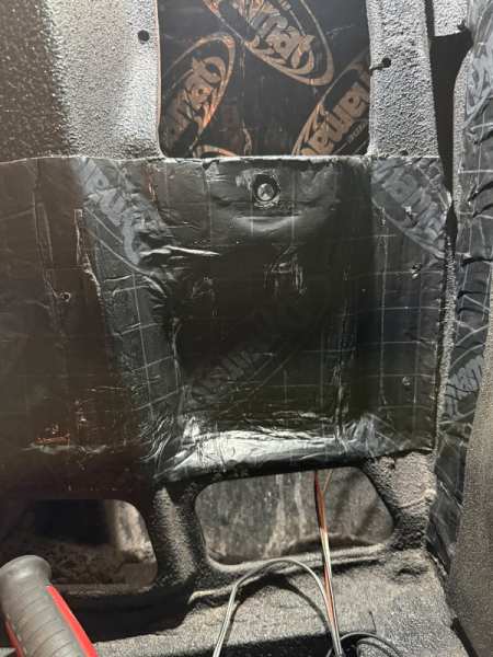

ghetdjc320 Posted August 19 Author Posted August 19 Had to make a small detour to patch a nasty water leak. Cutting out the old metal seam and getting some solid clean metal to work with. Then will weld it all up solid.
ghetdjc320 Posted August 22 Author Posted August 22 Well, that was a ton of work to design build and install, but well worth it.
