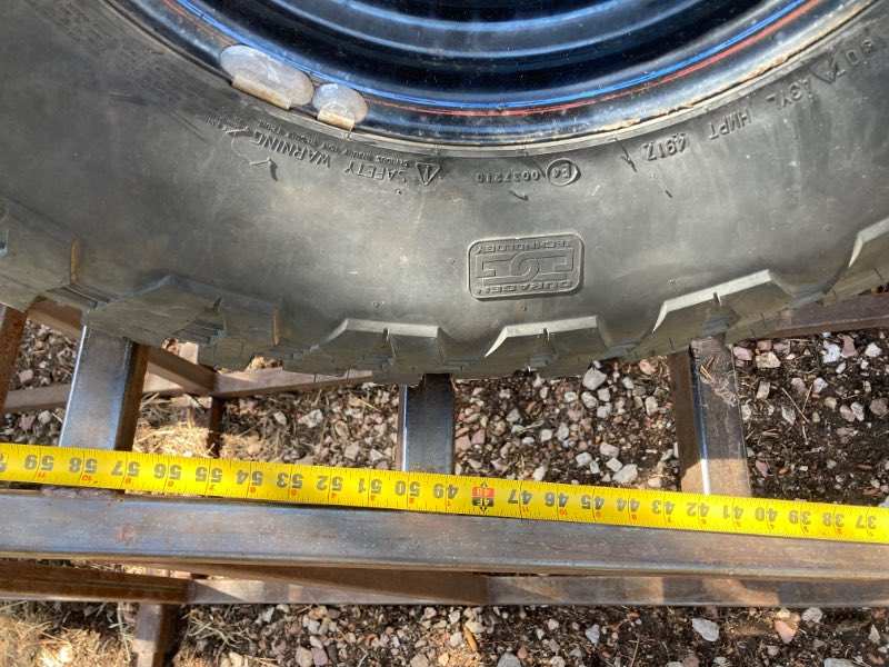

As for an update, I picked up an entire razor blade in a tire that I’m very pissed off about. Didn’t really look like much of an accident to me, but I have no evidence on anything... but I’m pretty sure who did it. :fistshake1: Anyhow, Pinky needs tires. I wanted to go with a 33” to get my final drive RPM lower, but my current 32x11.50s already rub the springs. I found these:
That is the General Grabber X3. They’re one of the few tires that can be had in a 33x10.50 size. Price was very good compared to other manufacturers in the same difficult size. They should be here by Thursday. Hopefully mounted this weekend.

Yup. Right rear tire had the razor right square in the middle of the tread. Looked to me like it was wedged under the tire so it could wait for me to back out of the parking spot. Who checks under their tires?... much less the one furthest from the driver’s door? Anyhow, I shared some “words” with someone last Friday... someone that has previously bragged to me about a past coworker that pissed him off so he spread boxes of nails on the dirt road leading to his house. Let’s just say that this person also works at the shop I work at now and this person left work early on this same Friday.
I brought the tire in to see if it could be patched. It was... kinda. They put the biggest patch they had on the inside (it wasn’t big enough), put a few layers of sealer on, and then it still leaked just barely. Granted the tires were old, but they weren’t cracked, they all still held air, still had enough tread for another season, and they still balanced great.
