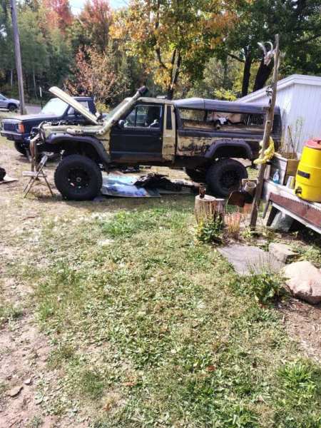

Well both aal were broken on each side, so yanked them out added new pins and plan to run it set back an inch to help with driveshaft length as I'm installing new Driveshaft thats balanced and with a new joint. So bushings were shot on shackles as well so decided to go with lift shackles and kill two birds on stone. Plan is to add a traction bar later. So putting everything back together tomorrow and hope to take a test drive with the rock lights on. :)
