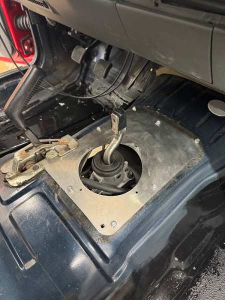

GonzoTheGreat Posted December 19, 2025 Share Posted December 19, 2025 I think @boxyjeep makes something for this https://boxyjeep.com/products/jeep-cherokee-xj-ax-15-tunnel-cover-1984-2001 It lets you use the TJ boot. Is that what you're looking for? I don't think it was available when this thread died in 2013 Link to comment Share on other sites More sharing options...
boxyjeep Posted December 19, 2025 Share Posted December 19, 2025 Here is what it looks like installed. Standard TJ boot fits perfect. Check out the link posted above for it. Link to comment Share on other sites More sharing options...
