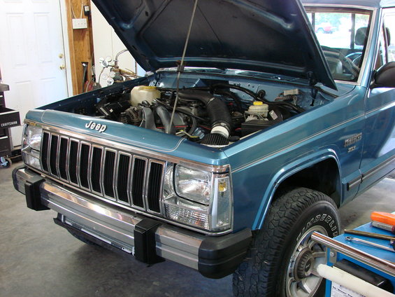

360MJDude Posted November 2, 2010 Author Share Posted November 2, 2010 Don't remember what motor mounts I used right off hand. I have the napa part numbers at home and will let you know what they are. We did weld mounts to the frame and can get some pics if you would like. The headers are summit brand block hugger http://www.summitracing.com/parts/SUM-G9064/ bare headers with POR 20 applied. Didn't prep them well enough for the Por but worked for mock up and for now. The stock oil pan cleared. We set the motor so that the oil pan would clearance the front axle by a few inches. The exhaust is a mandrel bend kit we cut and welded to fit. Its tight Link to comment Share on other sites More sharing options...

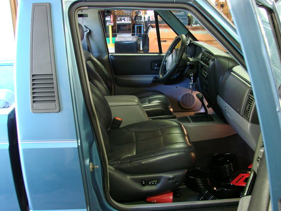

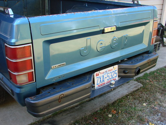

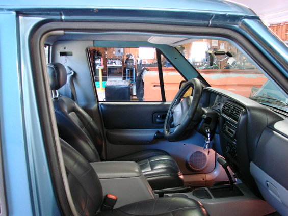

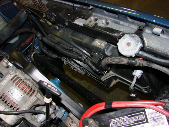

91MJdude Posted November 2, 2010 Share Posted November 2, 2010 New header gaskets makes for no leaks and great sound! almost finished interior, still lack window switches, B pillar lights, painting the blue plastics gray. The seats are nice, but since they are all power and heated they have a little more thickness to them. feels like your riding higher than you really are. still plenty of head room though. Taurus 2 speed fan with DCC controller, new turn signal and running lights... Found a emblem for the tailgate, soo sweet still need to paint the bumper and Fabricate a hitch engine bay is pretty much finished except for air-box and charcoal canister Link to comment Share on other sites More sharing options...
