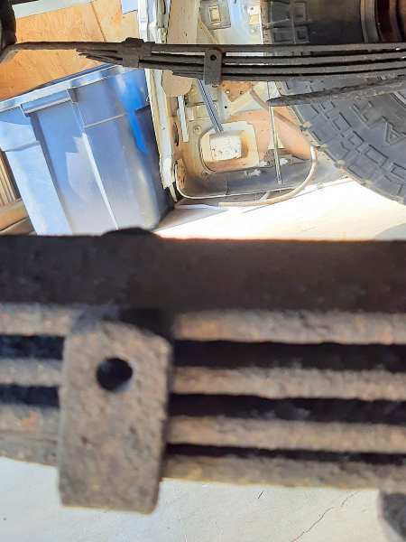

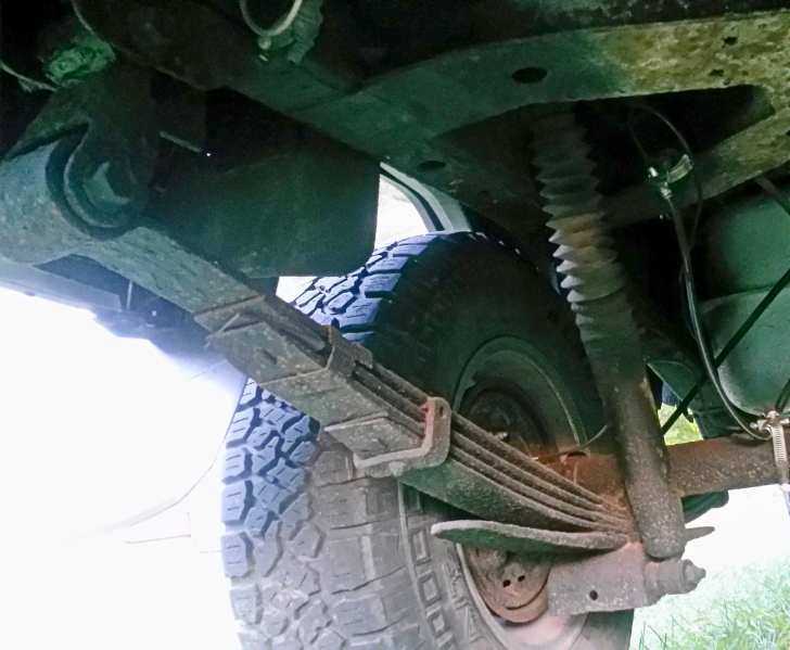

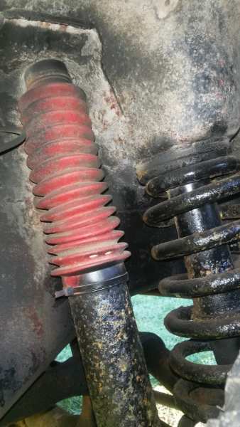

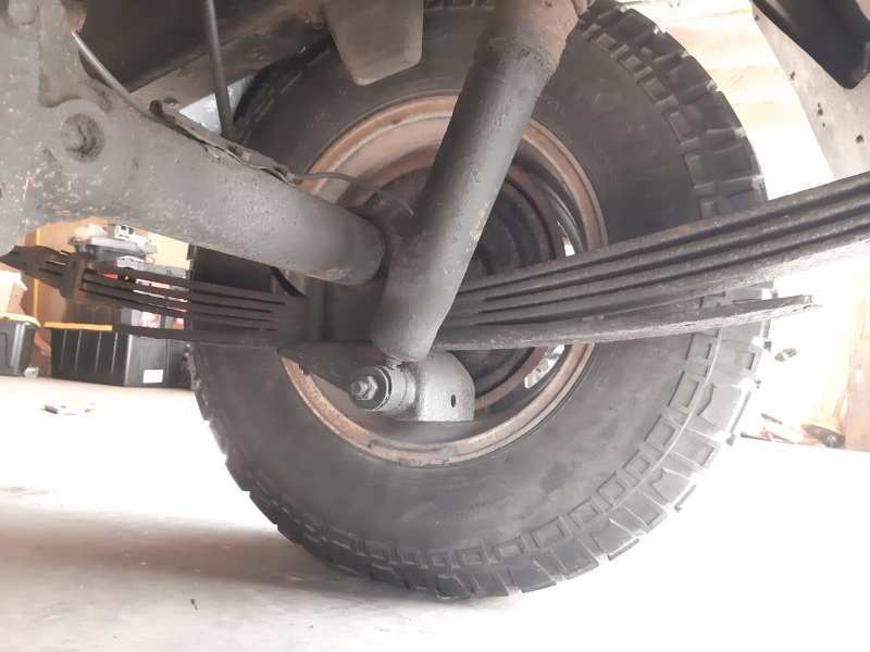

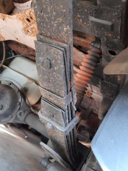

emosun Posted 7 hours ago Posted 7 hours ago The front coil springs used to be red. The shocks were white/red and said Rod Hall on them making me think they were Rancho rod hall edition shocks. How do I tell if the truck was lifted or not? Also sorry for the terrible photos my phone is broken so these come courtesy of a 2013 samsung galaxy. one thing i will say , this is a squishyest most comfy thing i've driven in a while. the shock still work really well for being maybe 30-40 years old.
eaglescout526 Posted 7 hours ago Posted 7 hours ago Still looks like factory suspension. Metric ton springs out back. Could be just old replacement rancho shocks.
