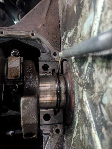

Eagle_SX4 Posted 4 hours ago Posted 4 hours ago Neither the transmission nor engine needs to be removed to replace the engine rear main seal. The only thing that has to be removed is the oil pan. Which you can remove if you unbolt the shocks and let the front suspension drop out of the way.
87MJTIM Posted 4 hours ago Posted 4 hours ago You don't have to pull the trans to change the RMS. The RMS is a two piece seal. You have to drop the oil pan and remove the rear main bearing cap. The lower half of the RMS is in the cap. Use a small brass punch to remove the upper half of the RMS.

87MJTIM Posted 2 hours ago Posted 2 hours ago Manual transmissions don't have inspection plates. The dust shield is a solid, single piece of metal. You have to remove the rear bearing cap to access the RMS.
