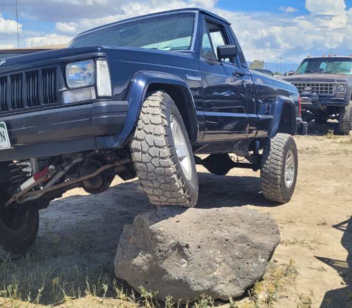

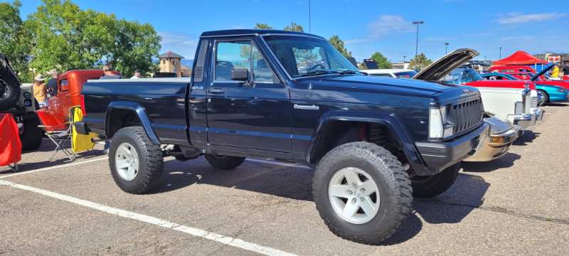

Build Thread-
Year/Model -
1991 Base
Drivetrain-
D30 front with the Posi-lok cable

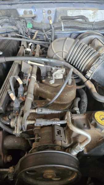

Stock 4.0L with 99' intake and power steering pump
M.O.R.E motor mounts

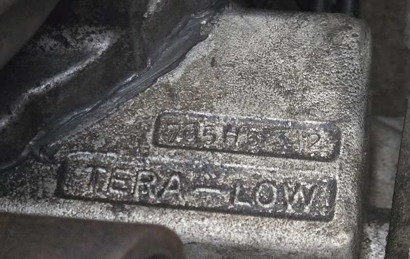

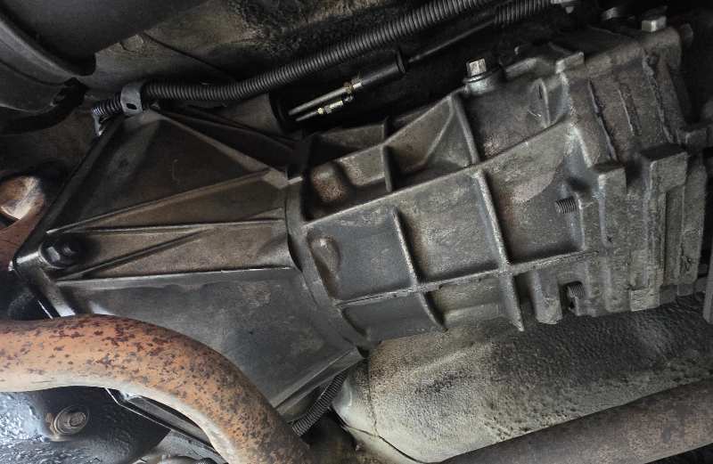

Ax-15

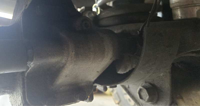

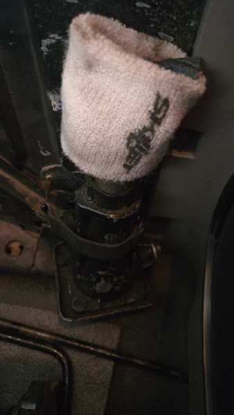

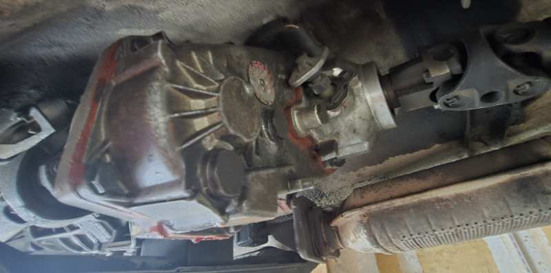

NP231 with the 4:1 Tera-low kit and slip yoke eliminator
98' ZJ D44HD rear
Cooling-
Napa 3 core copper radiator
Stock thermostat, housing, waterpump
Aftermarket aux fan with on demand switch in the dash
Electrical/Ignition-
Stock wiring
7-pin trailer plug

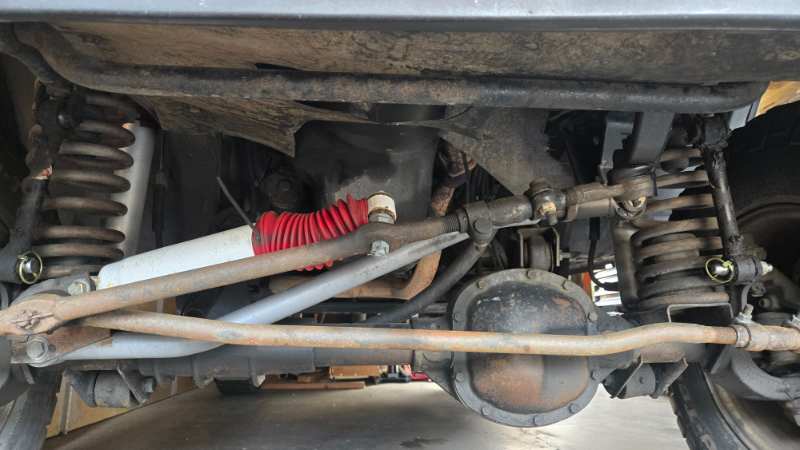

Suspension/Steering-
Tomken 6" front coils
Tomken front upper and lower control arms
98' ZJ Drag link & tie rod

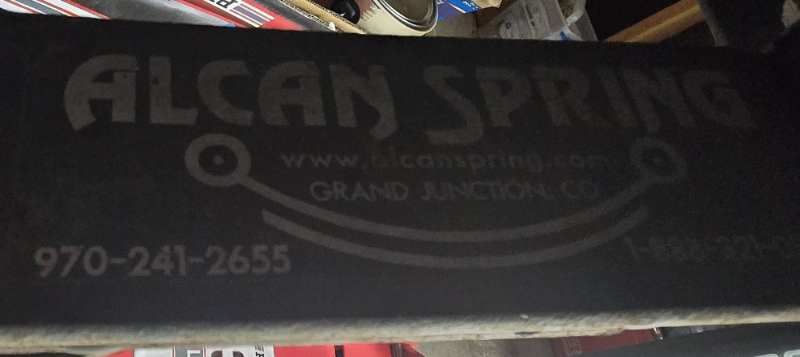

Alcan rear springs with XJ shackles
Interior-
Bluetooth stereo

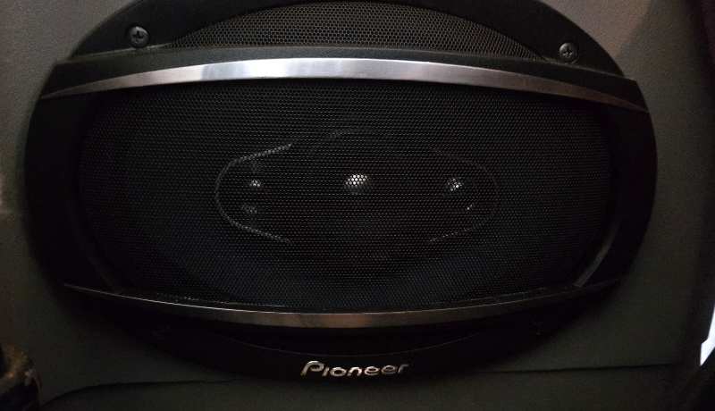

Pioneer 6.5" front, 6x9" rear speakers
XJ 2 door seats

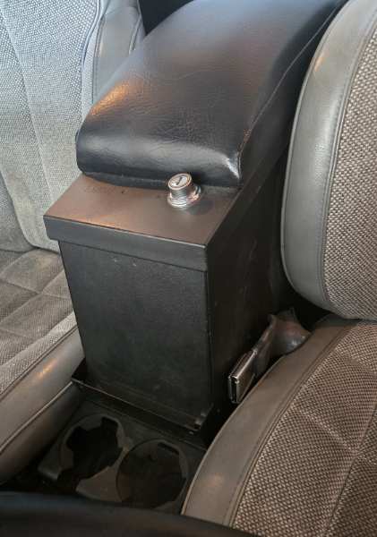

Tuffy CJ center console
Cobra 29 LTD CB radio

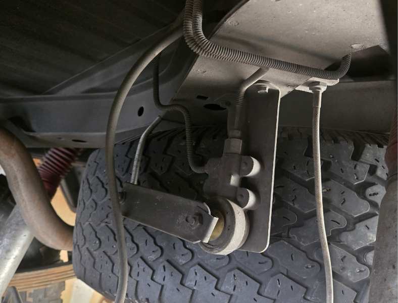

Brakes-
Stock system, missing linkage to axle, chose to adapt a spring to the proportioning valve.
Lighting-
Rampage H4 MSR headlights
Clear turn front turn signal lenses
Stock rear taillights
Stock dome lights
Exterior-
Rust is starting on a few of the body panels, will have to mitigate that soon. Trying to keep it dry as possible in the meantime.
Wheel & Tires-
Wrangler Moab wheels
265/75R16 (~32") Goodyear Wrangler MTR

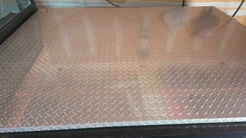

Custom aluminum diamond-plate topper
