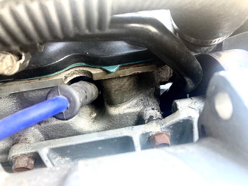

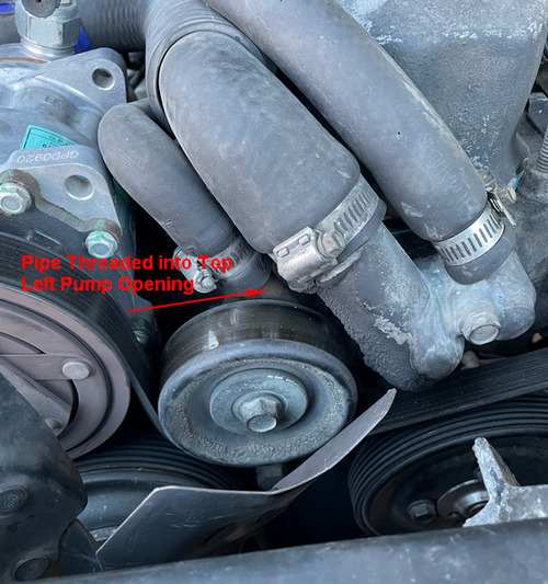

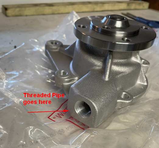

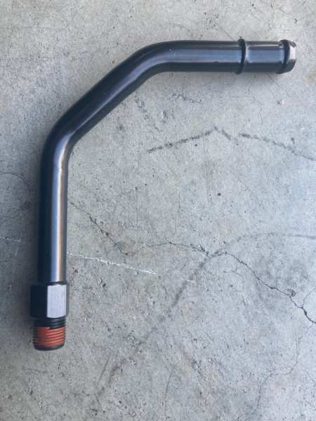

AnotherOldJeepGuy Posted December 18, 2025 Author Share Posted December 18, 2025 There's a short piece of pipe for the top hose connection. I hope I can reuse the one I have, but if not, is this a standard part I should be able to get at the autozone in walking distance? Also I assume I need to put some type of thread goo on there, I have plumbers tape but I suspect it can't handle the temps, so what do I use on this? Can I use the same RTV I will be putting on the mating surface when I install the new pump? Link to comment Share on other sites More sharing options...
fiatslug87 Posted December 18, 2025 Share Posted December 18, 2025 I’ve been using the tube for the HO and cut the hose shorter. Just make sure it’s lined up correctly before installing the pump. Link to comment Share on other sites More sharing options...
AnotherOldJeepGuy Posted December 19, 2025 Author Share Posted December 19, 2025 I like that idea although it looks like if I want to finish tomorrow I need to manage to salvage and reuse cause none of the close by auto parts outlets stock these, at least that's what they tell me on the phone. What are you using for tape? Link to comment Share on other sites More sharing options...
fiatslug87 Posted December 19, 2025 Share Posted December 19, 2025 When I reused the straight pipe I used silicone sealant, the HO ones come with that red sealant. Link to comment Share on other sites More sharing options...
GonzoTheGreat Posted December 19, 2025 Share Posted December 19, 2025 I believe its 3/8 NPT and you can get a new piece of pipe the same length with the threads already cut on both ends at home depot. The threads on the hose end should keep the hose from sliding off, but you might want to double clamp it. I've used teflon tape with no problems. Teflon is good 'til like 400C or something like that, so coolant temps are no problem. That's how my '88 was when I got it, and I didn't know until 3 years later when I took the hose off to redo the cooling system, but since it worked, I just kept the pipe. Link to comment Share on other sites More sharing options...
AnotherOldJeepGuy Posted December 19, 2025 Author Share Posted December 19, 2025 I like the home depot option if I can't reuse. Since I'll need to go there anyway maybe I'll look to see if they have any high temp Teflon, just in case. Link to comment Share on other sites More sharing options...
derf Posted December 19, 2025 Share Posted December 19, 2025 Auto parts store will have tubes of thread sealant. Usually next to the RTV and threadlocker. Link to comment Share on other sites More sharing options...
