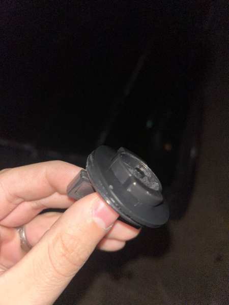

hgeranium Posted December 9, 2025 Author Share Posted December 9, 2025 Awful picture but I noticed that the gasket on my few month old oil cap was starting to warp and wasn’t seating properly anymore. Since I bought it at O’Reilly, it was under a one year warranty. I pulled the old gasket off, warranty swapped the oil cap, and double stacked the old gasket with the fresh one on the new cap. It’s on there so tight I felt like I was going to break the thing when reinstalling the cap. A few heat cycles should break it in though. I’m pretty confident about this version of cruisers oil cap mod though. I think it’s a lot easier than the cruiser recommended option of having/buying some innertube and cutting it to fit the cap or outright buying a sheet of gasket material. This should help with my crankcase pressure and VC leakage woes. Link to comment Share on other sites More sharing options...
pizzaman09 Posted December 9, 2025 Share Posted December 9, 2025 9 hours ago, hgeranium said: Awful picture but I noticed that the gasket on my few month old oil cap was starting to warp and wasn’t seating properly anymore. Since I bought it at O’Reilly, it was under a one year warranty. I pulled the old gasket off, warranty swapped the oil cap, and double stacked the old gasket with the fresh one on the new cap. It’s on there so tight I felt like I was going to break the thing when reinstalling the cap. A few heat cycles should break it in though. I’m pretty confident about this version of cruisers oil cap mod though. I think it’s a lot easier than the cruiser recommended option of having/buying some innertube and cutting it to fit the cap or outright buying a sheet of gasket material. This should help with my crankcase pressure and VC leakage woes. I stacked an extra layer of gasket on mine too, it helps some. Link to comment Share on other sites More sharing options...
llhat Posted December 9, 2025 Share Posted December 9, 2025 11 hours ago, hgeranium said: Awful picture but I noticed that the gasket on my few month old oil cap was starting to warp and wasn’t seating properly anymore. Since I bought it at O’Reilly, it was under a one year warranty. I pulled the old gasket off, warranty swapped the oil cap, and double stacked the old gasket with the fresh one on the new cap. It’s on there so tight I felt like I was going to break the thing when reinstalling the cap. A few heat cycles should break it in though. I’m pretty confident about this version of cruisers oil cap mod though. I think it’s a lot easier than the cruiser recommended option of having/buying some innertube and cutting it to fit the cap or outright buying a sheet of gasket material. This should help with my crankcase pressure and VC leakage woes. bought a new stant brand filler cap from ebay, while still new and un-used, put a very thin bead of red silicone between the bottom of the cap suface and the top of the gasket and allowed to cure, in effect making the gasket thicker... was very difficult to tighten up also thinking i would break it... been 'ok' for a few thousand miles now, but do not know if long term solution for this... maybe one day the later valve cover... but Felpro VC gasket not leaking... Link to comment Share on other sites More sharing options...
