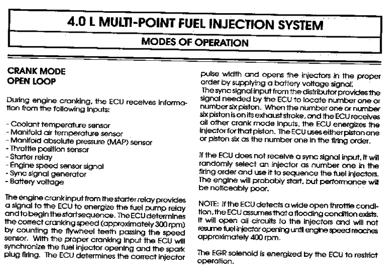

89 MJ Posted September 24, 2025 Share Posted September 24, 2025 29 minutes ago, AnotherOldJeepGuy said: Mine too. I've heard this is normal multiple times, but I don't know that I ever heard anyone explain why? So, can anyone explain why this is? IF I recall correctly (that’s a big if) it’s because the computer doesn't remember which cylinder is supposed to fire next after being shut off, so it needs to turn over for a while so it can determine which cylinder to fire. Link to comment Share on other sites More sharing options...
hgeranium Posted September 24, 2025 Author Share Posted September 24, 2025 36 minutes ago, 89 MJ said: IF I recall correctly (that’s a big if) it’s because the computer doesn't remember which cylinder is supposed to fire next after being shut off, so it needs to turn over for a while so it can determine which cylinder to fire. After some independent research I did see something about slower logic from the ECU means it takes longer to verify crank position, so I'm sure you're right. Link to comment Share on other sites More sharing options...
