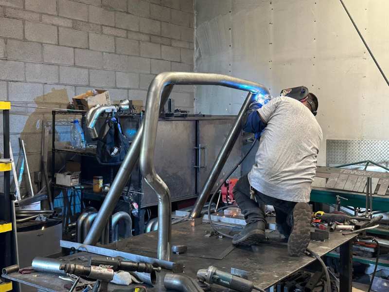

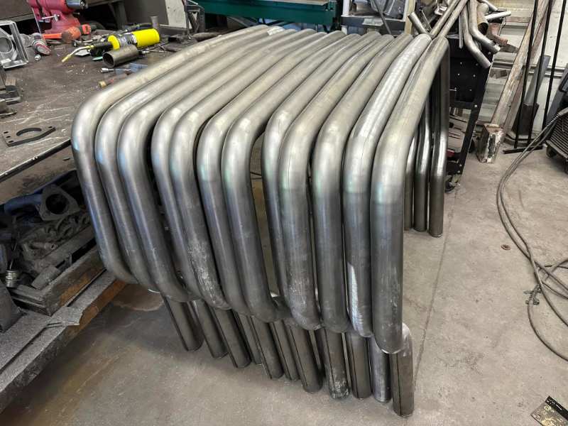

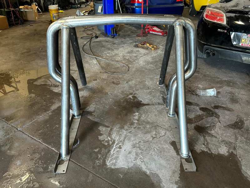

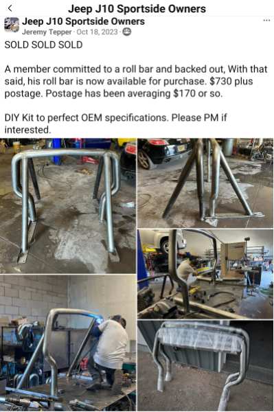

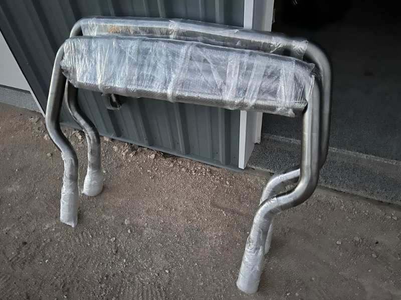

DesertRat1991 Posted July 15, 2025 Share Posted July 15, 2025 FYI... the J10 guys have figured this out. Sharing here just as an example of what's possible. Specs are 3" tubing, 20awg, CNC bent. They ship with some assembly req'd (last photo). Photo credit to the dude below: Link to comment Share on other sites More sharing options...
