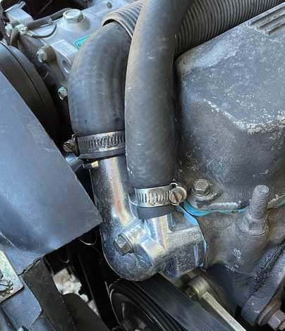

OK got my additive and flashlight, added the dye in today.  I made one mistake I'll note here for the benefit of anyone referencing, I neglected to snoop around with the flashlight before putting in the dye.  Why does that matter?  It matters because the black-light flashlight doesn't only work on the dye!  I can walk around my house and garage nowhere near my Jeep, and see things that will light up.  So, while I do see some specs here and there in my engine compartment, I really don't know they were not already there.  So for future reference, if you are doing this look around before you put the dye in and make note of any thing that already lights up!  If you see anything, if you can, clean it off so that it doesn't shine, then later if you see a shine you will be sure it came from the dye!  For me, this just means I need to clean up any specs I see, and drive around again.  I learn something new every day on this "keep my Jeep running" journey!
Turns out I have quite a lot of specs that light up, and I expect a lot of them are not really something that can be cleaned away.  But what I was able to determine was that the only glow that matched the expected glow was a small area at the thermostat housing.  I was able to match this to the expected color by swabbing the inside of the dye bottle with a q-tip and comparing any glow I could find to the glow on the q-tip.  This area at the housing is not an active leak, I can't see it leak.  That housing was pretty ruff when I replaced the gasket a few months back when I put in a new water pump, and it did have to do it more than once to get (I though) installed with no leaks.
This leak appears to be so small that I don't have a lot of confidence it is my only coolant loss, so the additional chemical analysis suggested will most likely still be done, but I'll try to eliminate this known leak first and see what happens.  (note it's all wet because of some cleaning)

I've watched while the temp came up from cold to around 190 and haven't been able to see it. :dry:  But since the dye is showing, and that's the best clue I have, I'll work on what I can find and see what happens.  When I have the thermostat housing off a few months back that housing wasn't in very good shape, and a new one isn't expensive so I guess I'll replace it and see what happens.

Finally cooled down enough here in TX to work outside again, so I pulled the old housing and previous thermostat, cleaned the block surface as much as I think I can.  Put the new housing one with the felpro gasket.  Still leaking in the same basic place as pictured on July 24.  It's a visible seep.

I still think for now I was successful putting on the tstat housing not leaking, but the hoses want to leak at that housing.  I think the larger one going over to the radiator may be OK once I tightened it more, but the smaller one going back to the heater valve continues to leak and I have tightened it as much as i can, so I guess I'll replace it.  I see in the parts cat the hose part number is 5600 4783, but as I tried the various parts websites, sometimes I find a cross and sometimes I don't.  So, can anyone tell me the ID at each end and I'll search that way.
I got out the calipers and started measuring, looks like Rock Auto AC Delco 18001L matches up pretty well.  Tstat housing end measured approx .8" and the pipe at the other end measured approx 0.65".  The wildcard here is when the bend occurs.  My measurement show a straight hose for approx 18", then bend and go approx 6 more inches.  The total length of the 18001L lines up but they don't spec the 2 lengths on each side of the bend, so once I get it I'll post if it's a match.
Decided to drop in a gotcha on the coolant dye.  It works great to locate the initial leak.  But going forward it is problematic.  Case in point, the original dye infusion located a leaking spot as noted earlier on July 24.  The gotcha comes along with the fix.  It was pretty much impossible to remove the tstat housing without contaminating the edge of the water pump gasket when you remove the original tstat housing.  I did try with a garbage bag and shop towels to keep from getting coolant on things like belts, pulleys, and the engine area just below it, but it was not possible to capture all the coolant.  I know from my previous snooping back in July there was no leak identified by the dye around the water pump.  And swapping out the tsat housing didn't require disturbing the water pump installation in any way.  But now that even a little of the dye managed to get on the exposed part of that gasket, it now lights up.  Other solid surfaces  where the coolant got to can be cleaned off with just water, but the gasket material sucked it in, and that can't be washed off.  Since I didn't have a leak at the water pump before, I am sure I don't have one now either, but unfortunately the UV flashlight would like me to believe otherwise.  Thought this was worth sharing for future reference.
