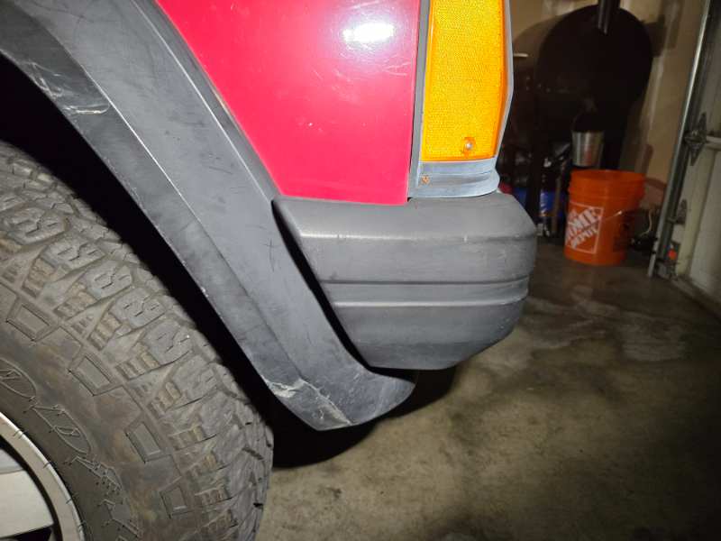

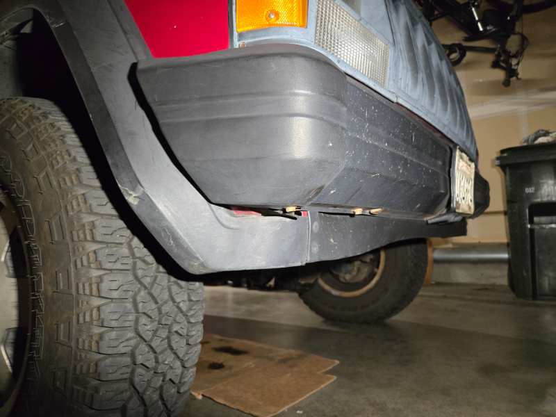

James92 Posted April 8, 2025 Share Posted April 8, 2025 This might be a stupid question.. but what the heck is going on with my front bumper? I thought someone had cut the bracket to make it sit flush with the grill, but the bracket looks original and unmodified. I'm trying to convert it back to stock. Running to the junkyard tomorrow. Hopefully can pick up a clean XJ bumper. Thank you Link to comment Share on other sites More sharing options...
eaglescout526 Posted April 8, 2025 Share Posted April 8, 2025 It’s definitely tweaked. Link to comment Share on other sites More sharing options...
Comanche SS Posted April 8, 2025 Share Posted April 8, 2025 It’s pushed in, the bracket should only be bent to 90* and yours looks much further than that Link to comment Share on other sites More sharing options...

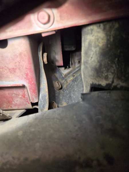

Eagle_SX4 Posted April 8, 2025 Share Posted April 8, 2025 7 hours ago, James92 said: Those three bolts should be on the same plane (flat with each other). It looks like you will need to straighten that area of the frame. Link to comment Share on other sites More sharing options...
James92 Posted April 8, 2025 Author Share Posted April 8, 2025 Ah, man. I was really hoping it was just the brackets and not the frame. That's a bummer. Thanks for the help guys. Link to comment Share on other sites More sharing options...
Gjeep Posted April 8, 2025 Share Posted April 8, 2025 From your pic, I don't think the frame is damaged. You'll see once you have fun unbolting all of that. You can most likely easily straighten the sheet metal that serves as attaching points of front most bumper brackets. My wife drove into a cross traffic dump truck one time with my '95 XJ long ago -- don't know how she missed it or how more damage didn't happen -- but looks similar. Was fixable. Link to comment Share on other sites More sharing options...
89 MJ Posted April 8, 2025 Share Posted April 8, 2025 I’m with Gjeep. I think it’s just the front sheetmetal that is in front of the crossmember that is bent. New bumper, bumper bracket, and a little bit of massaging you’ll be good to go. Link to comment Share on other sites More sharing options...

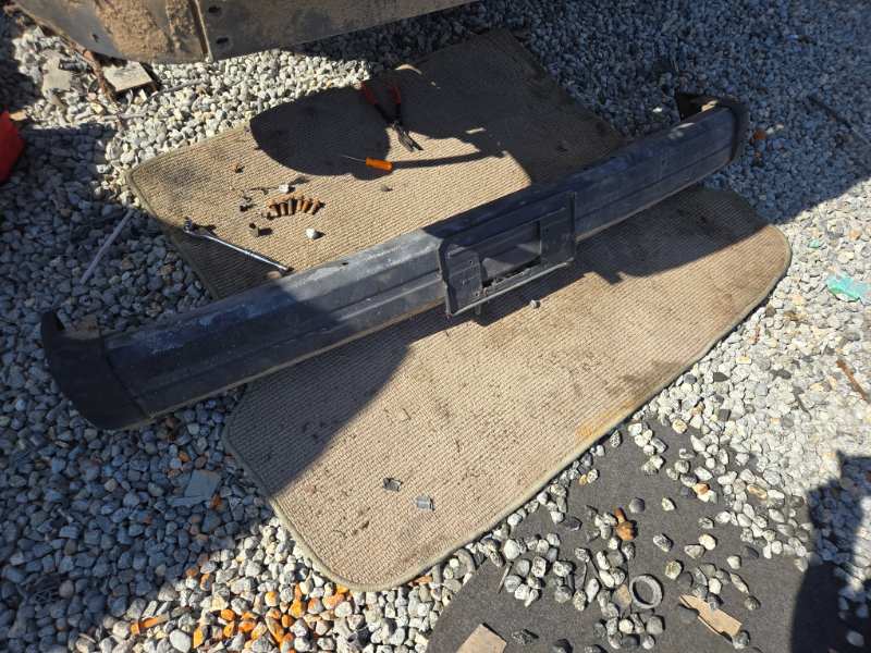

James92 Posted April 8, 2025 Author Share Posted April 8, 2025 Sweet! That's good to hear. I took the day off and ran to the junkyard. They got a comanche in over the weekend. Pulled the front bumper and brackets - it's very straight. Hopefully that's all I'll need to fix this. If anyone needs anything, I'll be here pulling stuff for a little while. Most of the comanche stuff is already gone. Link to comment Share on other sites More sharing options...

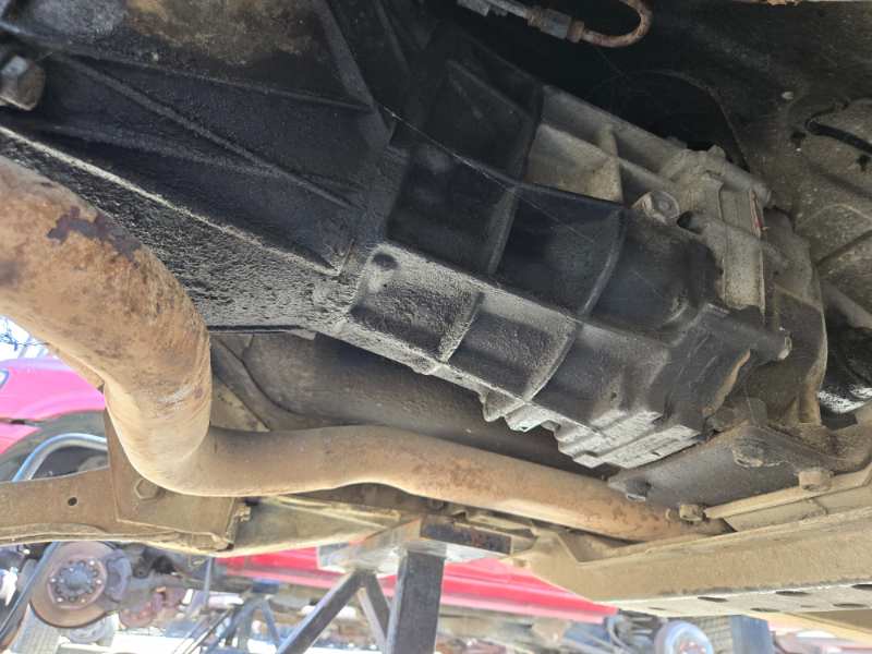

James92 Posted April 8, 2025 Author Share Posted April 8, 2025 Dang this actually has an AX15 in it... the temptation to pull is strong. Link to comment Share on other sites More sharing options...
89 MJ Posted April 8, 2025 Share Posted April 8, 2025 I say grab it. I feel like it’s also worth noting that I’m borderline a hoarder. Link to comment Share on other sites More sharing options...
Eagle_SX4 Posted April 8, 2025 Share Posted April 8, 2025 22 minutes ago, James92 said: Dang this actually has an AX15 in it... the temptation to pull is strong. It might be worth pulling if it is a 4wd transmission but if it is a 2wd I would leave it there. Link to comment Share on other sites More sharing options...
James92 Posted April 8, 2025 Author Share Posted April 8, 2025 1 hour ago, Eagle_SX4 said: It might be worth pulling if it is a 4wd transmission but if it is a 2wd I would leave it there. It was a 2wd Link to comment Share on other sites More sharing options...
