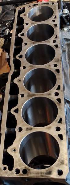

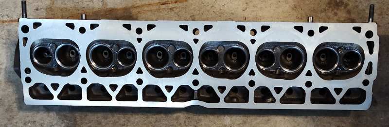

Picked up the block and head from the machine shop. They look great. Now I need to order pistons, bearings and gaskets then I can put it together. IMG_20260831_1838572972.jpg.9711214e92f1c8399ce29d67d7973608.jpgIMG_20260831_1839121402.jpg.7a2b72c9aaba9552d1d24f65a0a25304.jpg

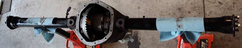

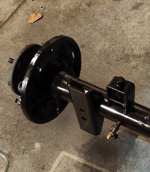

Good news is I got my axle sealed up and it is ready to have perches and shock mounts welded on. Also I got my AX15 torn down for the rebuild. Waiting on parts to put that back together.

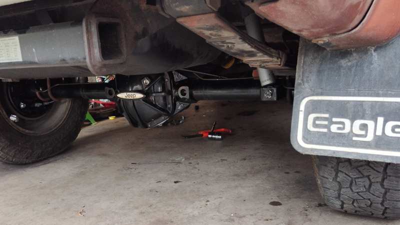

The transmission and transfer case are in and the rear axle is in place. Driveshafts have been measured and both will need to be about 2 inches longer. I started on a custom transmission mount that will use the factory cross member.
