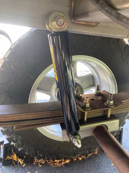

Work continues. Gave the tent an overnight Oxi-Clean bath which removed all the mold/mildew stains, I was amazed, pictures will come once it’s back together. Cleaned and repaired all the structural supports including the springs which turned out really nice.
Before:
After rust removal:
