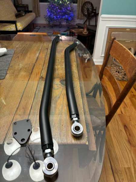

Thanks! It is a sloooow project. I'm about at critical mass with parts that were missing for the whole drivetrain & 4X4 swap, multiple component upgrades, etc. As soon as I get the front frame and engine bay painted it'll pick up speed. Initial progress on the passenger side wheel well:
Other front end bits done. And I found the front splash shields at Detroit Muscle Technologies. They also have the main splash shield for early XJ and MJ as well as later XJ. I’m holding on that piece until I can figure out if it’ll work with some alteration after the big steering box brace kit and IronMan track bar brace go in.
Rustoleum Colonial Red is a very very close match to what the last cheap paint job put on this rig.
