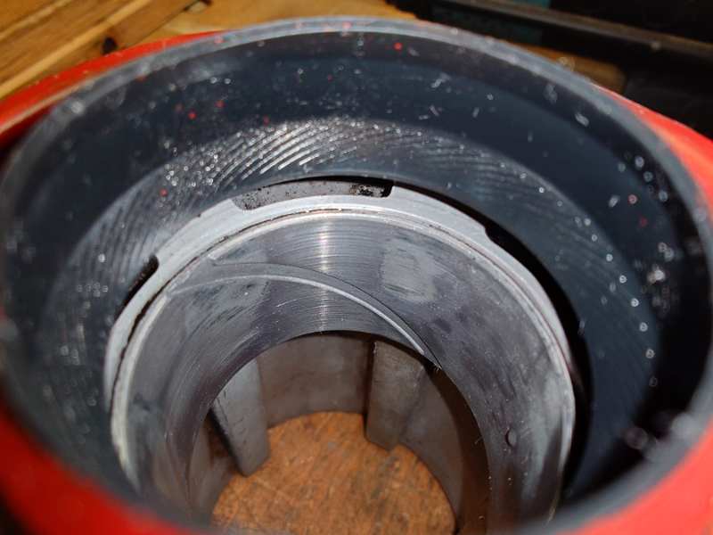

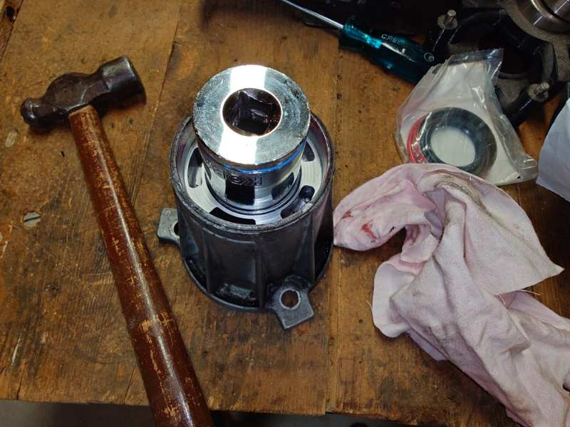

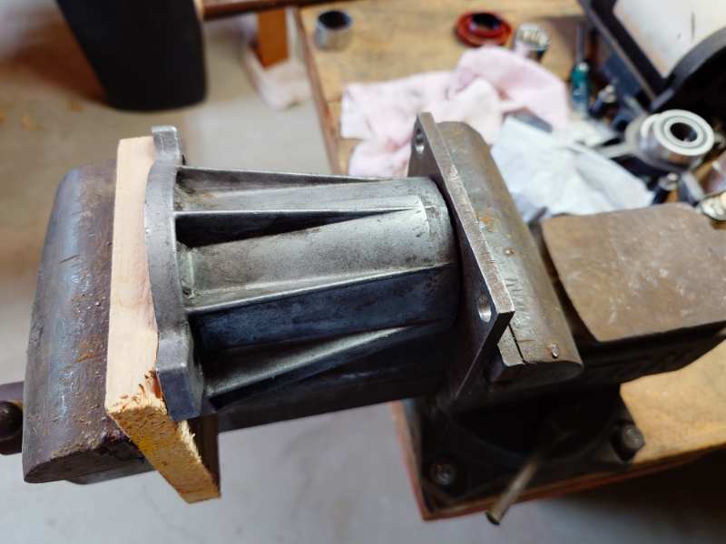

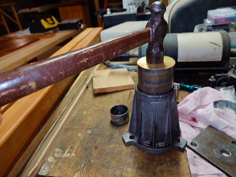

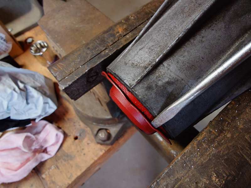

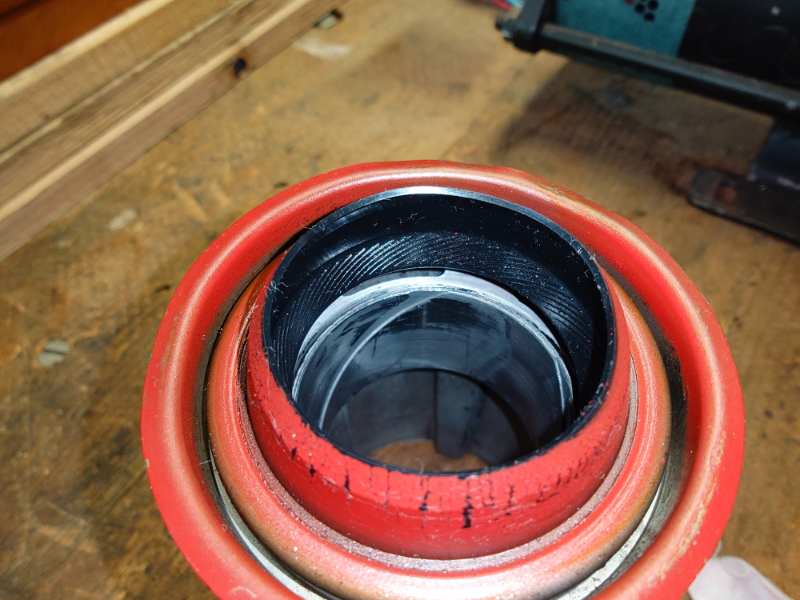

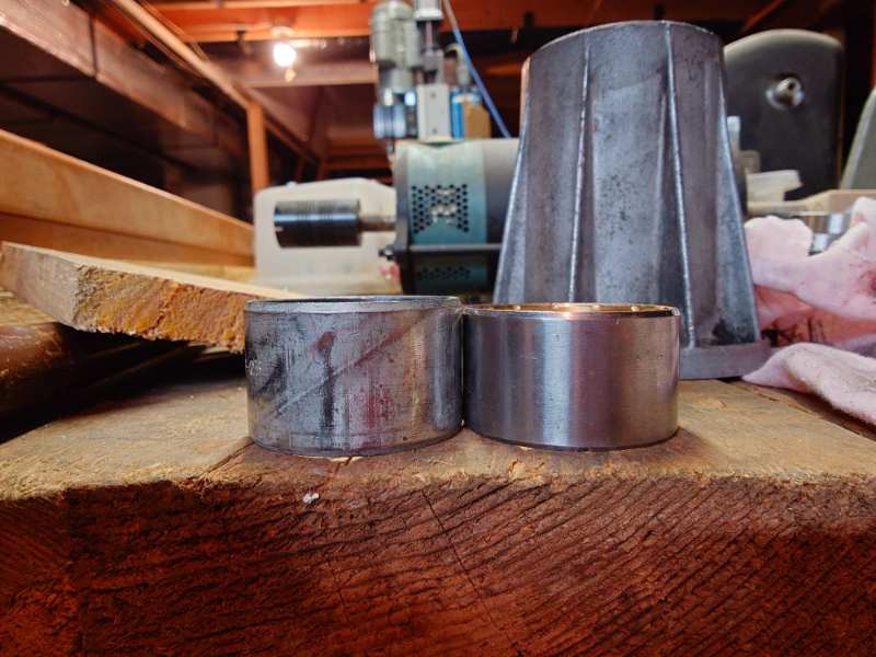

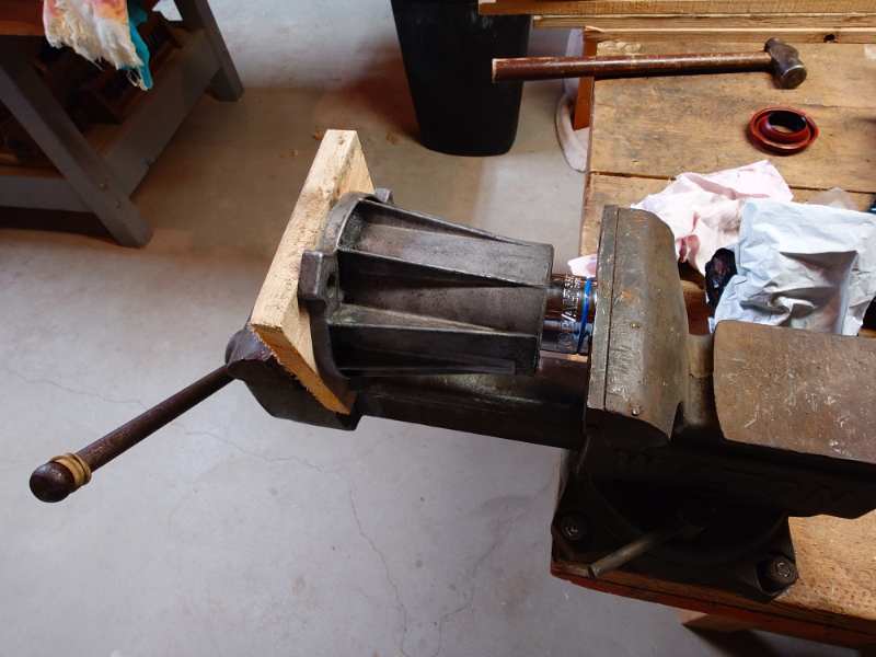

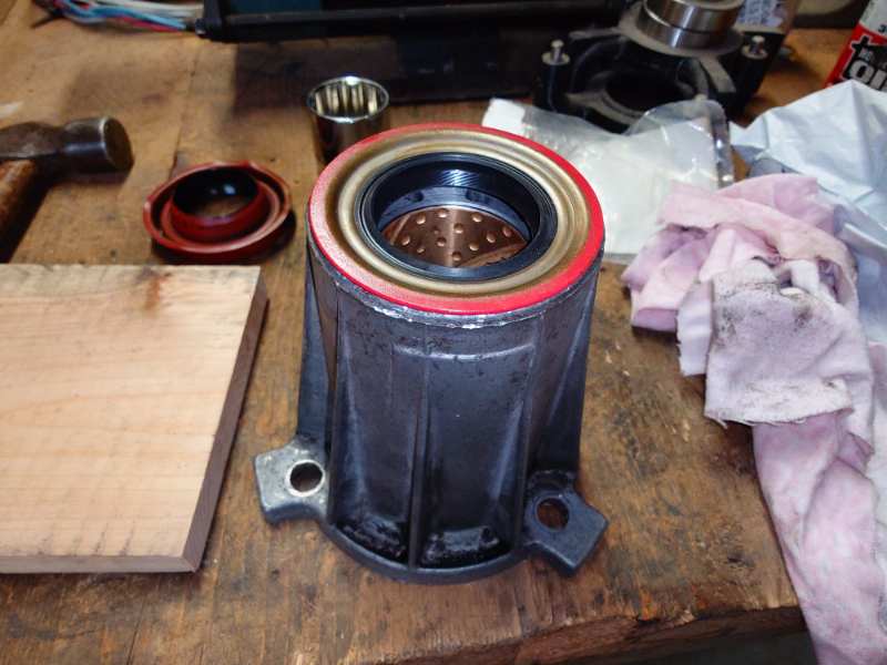

pizzaman09 Posted September 19, 2025 Author Share Posted September 19, 2025 The output shaft of my transfer case has been leaking, even though I changed the seal. So I figured the bearing was bad. Changed them both out today and low and behold, now the truck doesn't shudder when pulling away from a stand still. A little write-up is below. I had drained the T-case fluid and removed the drive shaft and tail cone. As you can see there is some wear on the original 275k mile bearing. I used a screwdriver and a hammer to work the old seal out, this went well as I only out the seal in last year. A 30mm socket, the same used for removing the drain plug from the NP231 T-case, fit nicely to remove the bearing. I started it with a hammer then moved to pressing it out in a vice. I did find that my new bearing on the right was a tad shorter than the original. I used a piece of bronze that I had laying around to drive the new bearing in with a hammer. The new seal got pressed in via the vice and a flat plate to prevent damage to the seal and a block of wood under the other end of the cone to also prevent damage to the sealing surface. I used a touch of RTV between the T-case and cone and a bit of blue Loctite on the three bolts. Make sure when reinstalling to point the drain slot down in the cone, I am not certain but it looks like one could clock it upside down and that might cause fluid to build up against the seal and not drain back towards the T-case. Link to comment Share on other sites More sharing options...
