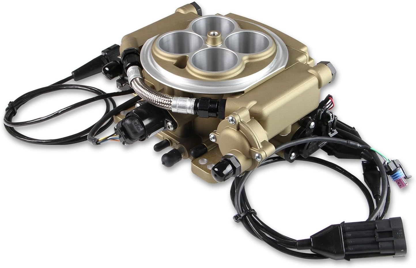

89 MJ Posted March 13, 2020 Author Share Posted March 13, 2020 1 hour ago, Jeep Driver said: Is that a Holley kit? Does it fit on a 4.0 intake. Oh, and I think I’m going to keep the truck, so I’m not as worried about budget anymore. Link to comment Share on other sites More sharing options...

Jeep Driver Posted March 13, 2020 Share Posted March 13, 2020 5 minutes ago, 89 MJ said: Is that a Holley kit? Does it fit on a 4.0 intake. Oh, and I think I’m going to keep the truck, so I’m not as worried about budget anymore. If I were to do it all over again............I won't.........but.......... I'd use the 2 barrel Sniper on the 2.5 It's the way of the world now...........these 'stroker' guys have not caught up yet. Mix at the plenum, not at the valve. I know others have done it, see what you can find. Leave the Renix/Chryco people behind. Link to comment Share on other sites More sharing options...
Jeep Driver Posted March 13, 2020 Share Posted March 13, 2020 Also- just a pic but you get the idea. Link to comment Share on other sites More sharing options...
89 MJ Posted March 13, 2020 Author Share Posted March 13, 2020 12 minutes ago, Jeep Driver said: If I were to do it all over again............I won't.........but.......... I'd use the 2 barrel Sniper on the 2.5 It's the way of the world now...........these 'stroker' guys have not caught up yet. Mix at the plenum, not at the valve. I know others have done it, see what you can find. Leave the Renix/Chryco people behind. I’ll look into that. Thank you. I always appreciate your different point of view. Link to comment Share on other sites More sharing options...
ghetdjc320 Posted March 13, 2020 Share Posted March 13, 2020 Ok, I was probably the first to ever try the sniper route and bought the original Holley sniper in 2017 for my stroker YJ. Used a Clifford 4 barrel intake. Suffice it to say, there is such a thing as too much carb/tbi. The sniper has large injectors and can keep up with fairly high cfm requirements. On a stroker it was cutting the injector pulse down far to low to get the right afr. Since then, they have released a Jeep specific tbi/efi unit along with a nice distributor (for a 258 but fits the 242/4.0 also) for timing control. The Jeep specific unit is very likely to be too tall to fit under the hood of an xj/mj since it was made as a replacement to the old carter/bbd carbs for the 4.2s. At the moment, don’t get bogged down in what injectors, throttle body etc. you will need. You need to build your engine internals first and then figure what the engine will require. It’s true, you could figure that all out now but if you want actual practical advise please tell us what kind of “stroker” you are planning to build. You have referenced a “kit” several times and we keep asking for the specs but haven’t received any. A stroker can be anything from a 4.2 mini stroker with a 232 crank to a 5.0 monster with offset ground custom crank. They will all have different requirements. Once you post up what you plan to build we can provide valuable input. Until then it’s all just speculation Link to comment Share on other sites More sharing options...
