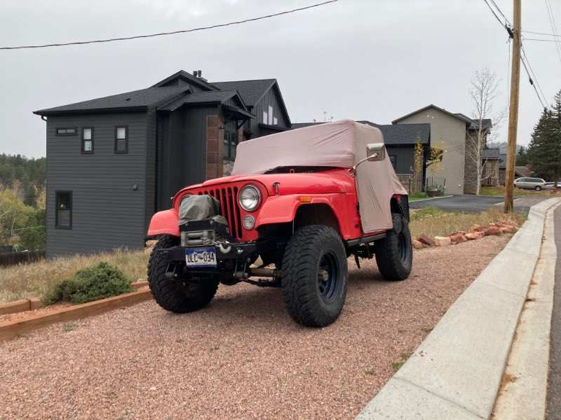

Has anyone else noticed that the weather is changing? Its been a breezy and chilly weekend at the house and it really got me thinking about what to do with the ol’ Pinkster. Sadly, he’s been neglected over the past month or so. I was trying to think of the last time I drove it and I really had to think. Had a few errands to run today so I used it as an excuse to turn the key. Pretty good lifter clack! Reminds me that I need to change the oil as its been about 800 miles since I rolled in the new bearings.
As for today, a cold breeze and the all too familiar clunks and rattles from every direction needed to stop. Went to the hardware store and grabbed some weather stripping along with scouring the junk drawer for the only roll of tape in the house.

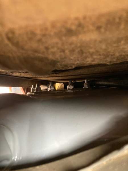

... and I crawled under it to check on my fuel filter status.
See, I started running two filters after I had some issues with it stalling while driving. Over the past few months after the fuel injection swap it would occasionally die, I’d throw in a new filter, and it’d be fine for a while. Unfortunately, Pinky sat for about five years before even the previous owner let him sit. I added the super cheap plastic filter so I could keep a better eye on things. Call it a pre filter? Anyhow, it looks like I’m due for another soon. I really need to just drop the tank and clean it out.

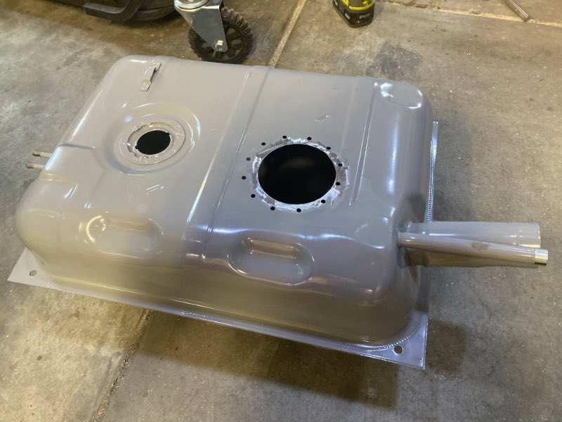

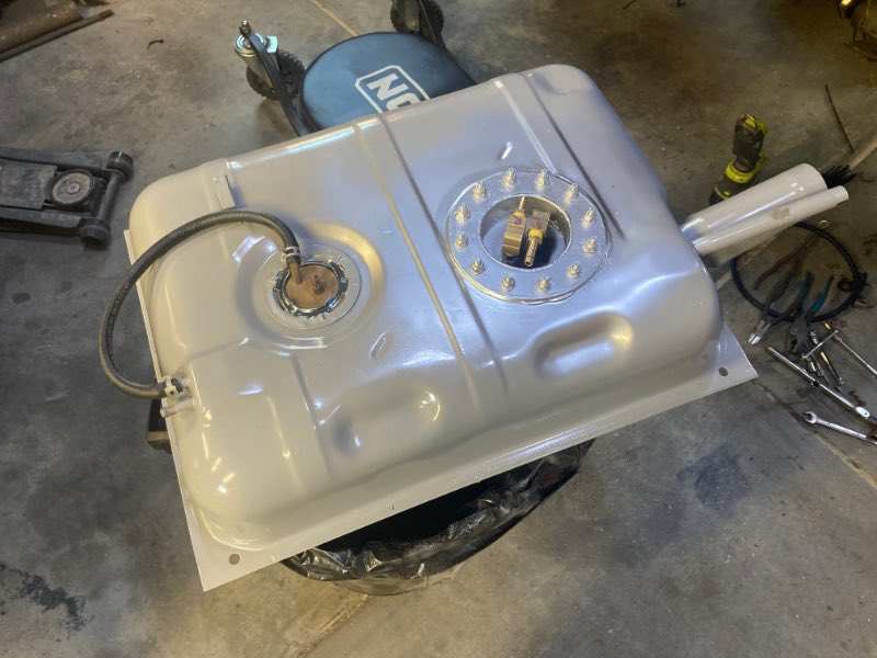

Fuel injection is still awesome. Fuel pump is loud though. An in-tank unit would be nice. Long term I’d like to build my own tank. Stock is just 15 gallons and most aftermarket (from what I’ve found) are either the same 15 gallons or a giant 30 that hangs way down. 20 sounds like a nice number!
