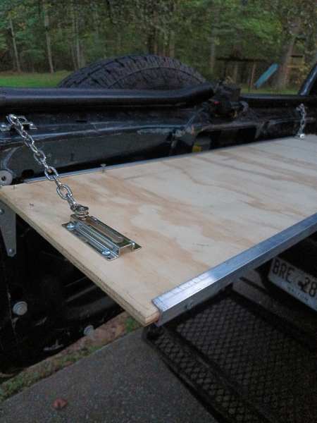

I'm still trying to figure out how to properly support it underneath.  the chain lock works great to prevent it from collapsing when bumped, but hardly strong enough to support any real weight.
These shelves are very handy and you could use the same design on your tail gate shelf.

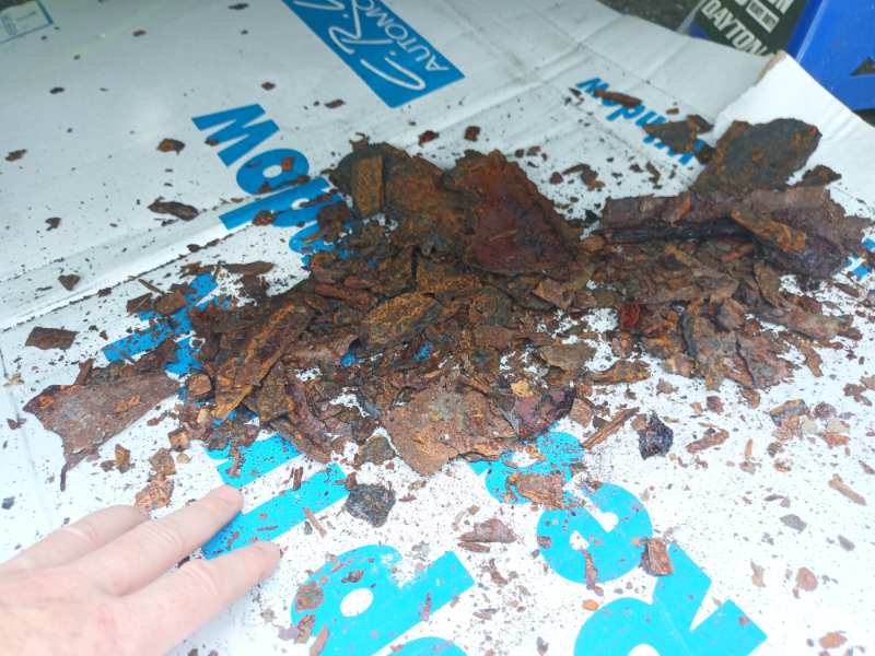

and I finally got a chance to empty out the driver side rocker like I did the pass
:crazy: I hate the thought of emptying body panels that sound like maracas.
yeah, it's been my plan for a while now to buy a clean body with a blown v6 and swap stuff over, but that's a heck of a project for a couple feet of rotted rockers that are covered by plastic anyways.  :dunno:  especially now that the suspension and axles and doors have been replaced already.

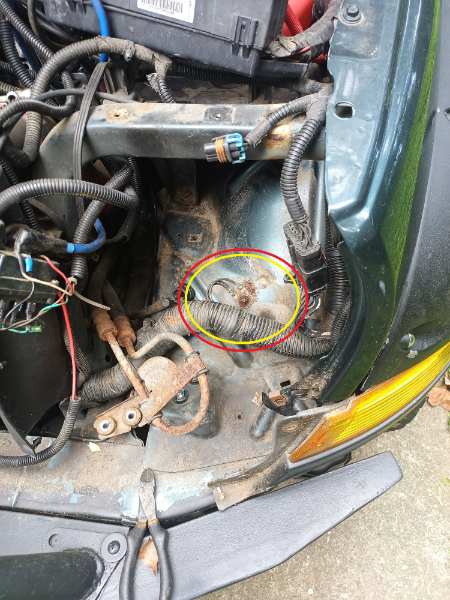

got to drive home in proper limp mode today.  according to the almighty internet, it appears one of the grounds in the engine bay is toast.  all the things that went wrong ground to that spot.  I'll look into it this weekend.
I do believe I've found the problem. that used to be a grounding bolt.  rerouted the wires to a new location and we're back to where we were before.  driveable, but not exactly impressively powerful.  next up, I've ordered new air and fuel filters.
indeed.  I would have addressed it years ago except that all the other ground points have been fine and this one is especially buried.  out of sight, out of mind and all that.  :doh:
exceptionally poor design here.  it was covered by insulation and the harness and had a bunch of debris trapped around it.  it was doomed on a rig that's seen salt. :(

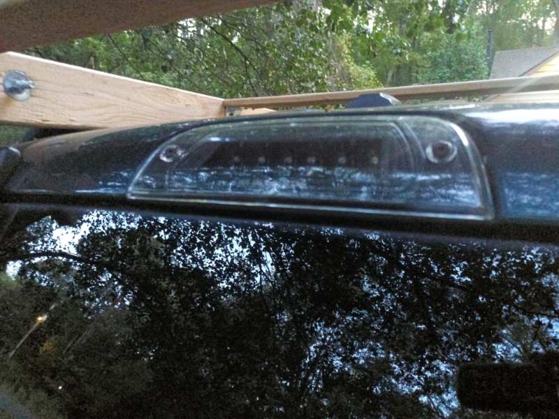

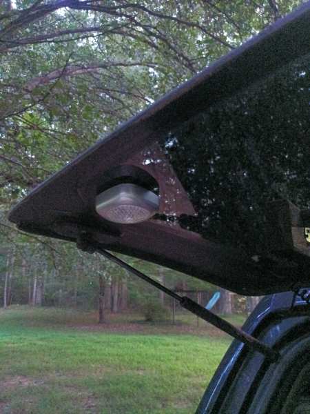

installed a new LED upper brake light, stiffening rails and a second chain for the folding workstation, and a pair of tap lights on the glass so I can see what I'm doing :D

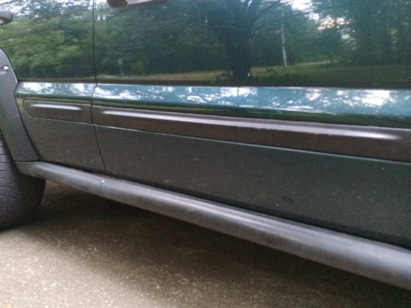

finally installed the trim I painted months ago

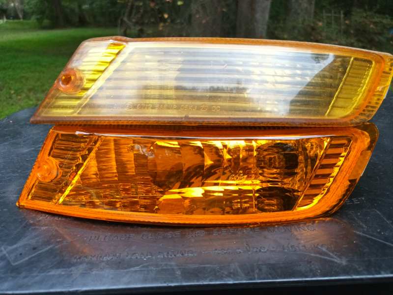

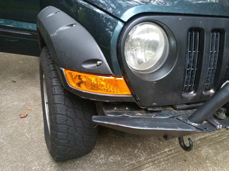

and figured it was time to change out the turn housings (sockets needed replacement and the housings are practically free if purchased as a unit)

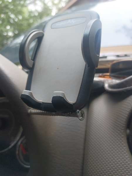

leds and resistors are installed in the front turns.  plus I figured out how to keep my phone holder from vibrating due to the engine.  it was nothing a wood screw and a little hot glue couldn't solve :D

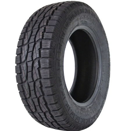

been pricing tires.  I think I'll be going with some no name walmarts, as brand name tires are way out of my price range.  something that looks cool, but is 100-120 each (plus mounting). can't seem to find anything used in my area in a 265/70 or 275/70.  the ol' girl doesn't really see snow anymore and is retired from towing, so I'm not too picky as long as they take a balance and don't look like generic "car tires".
settled on the RoadOne Calvery AT in a 265/70.  111 buckaroos each at wally world (which is currently a bit more than half off!)
hopefully they are a decent tire.  :peep:

side note, walmart isn't kidding when they say "Product May Vary From Picture"
