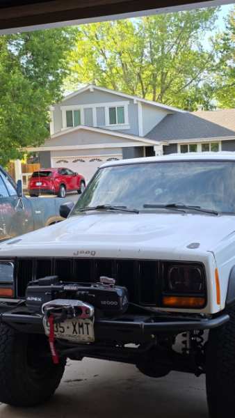

natander2ksometime Posted September 1, 2017 Author Posted September 1, 2017 So I got my front bumper put on, did some longer shackles in the back, and put these LED cube lights in. I'm really liking how it looks now. Hopefully going out this weekend to play in the hills.

natander2ksometime Posted October 28, 2017 Author Posted October 28, 2017 So I did a bunch of things. Dana 30 with 4.88's and Currie steering, Chrysler 8.25 with 4.88's and a Powertrax No-slip, 4.5" coils up front with adjustable uppers, upgraded injectors, Dodge Dakota 23 gallon fuel tank....And I got the camper shell on in time for winter. Now I just need to find time to take it out and wheel it!
