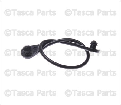

Yep, same cap. You can also buy a new Mopar tether like the one below (p/n 5278461AA), drill a 1/4" hole in the center of your existing gas cap handle and another in the fuel filler pipe liner, then pop the tether ends in the new holes. I did mine a long time ago with a locking gas cap.
Just removed one of the sheet metal screws and drilled it out to 1/4" instead of drilling a new hole. There are two others still holding the collar. The two random 3/8" holes were too large to use, and I have no idea why they are there. Do you have these holes also on your 91?
