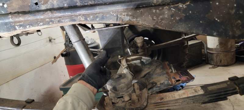

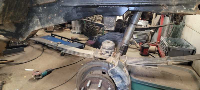

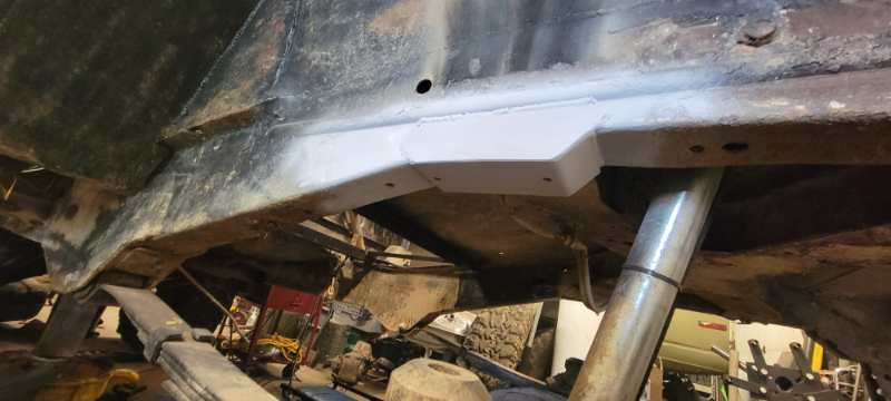

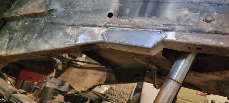

ThatJeepGuy Posted January 12, 2025 Author Share Posted January 12, 2025 New mount is underway! Unfortunately there doesn't look to be enough room on the axle end to add the boxed mount where I want it soo just focusing on a new frame side mount for now. Started out by removed the old bracket and track bar. Welded a bit more of the unibody seams here. Did this a few years back to some of the area while at the Badlands offorad park as the unibody was literally falling apart. The more it's tied together the better! Did a little copy and modify with tracing the old mount and factory bolt locations to some leftover 1/4" plate I had. Honestly wanted 3/16's like the prior mount but this was on hand soo it'll do. Made the outside plate wide enough to offset the new mount some, this also gave me enough room to add a 5th mounting bolt. Straight eyeball guestimation here and it landed right where I wanted it New bottom plate covers more of the unibody than previous Thanks to Offroad Anonymous and their fair priced custom bracket selection - offset panhard mount outside the frame. Tacked together and tape lines drawn, it's looking pretty close. Add to that its almost 4" longer than the old setup as well. Just about 3" shy of matching my steering length. New vs old mount new toob and heim joints to come! Link to comment Share on other sites More sharing options...
ThatJeepGuy Posted January 19, 2025 Author Share Posted January 19, 2025 Let's kick this off! find a true center for reference. $40 Lazer level from the jungle site. Formerly only 28.5" Cut the bar and sleeved it and now we have 32.25 Set it down on the bumps to check clearances and everything looks good! No coil springs Here we have the sleeved old track bar and the to-be-welded new track bar New track bar mount in a mockup weld jig Had some extra time so I poked around a slow startup issue I've been having. Haven't been hearing the fuel pump prime at key turn lately, had me a little worried I'd be dealing with replacing the fuel pump but when I was checking fuses and relays I found a bit of corrosion and after some wiggles the fuel pump was alive again. Not surprising also found corrosion on the distributor can and rotor - rock auto tune up here I come. Planning to weld up the track bar and mount this week, hoping next weekend I can tackle this tune up and some terminal cleaning. Plenty more on my mental to do list soo absolutely more to come! Link to comment Share on other sites More sharing options...

ThatJeepGuy Posted January 27, 2025 Author Share Posted January 27, 2025 Mmmhmm track bar and brackets welds Years ago now I did one of these *bleepin jeep* accessory fuse/relay boxes converting a factory unit. It's about time for someone a little cleaner and more compact. The other main things here is I'm retiring the factory plastic battery tray in favor of a Barnes4wd unit and also contemplating revamping the power and ground cables... we shall see how that goes but for now it's just been tidying the engine bay up some re routing some accessory wires, and improving the fitment on this Thor intake More to come Link to comment Share on other sites More sharing options...

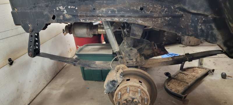

ThatJeepGuy Posted June 8, 2025 Author Share Posted June 8, 2025 Soo I have found myself with another list of repairs. This last wheeling trip was a short one cutoff by multiple leaks. Steering box, transmission fluid and fuel cut me short. There was also a chunk from my driveline i needed to trouble shoot. Essentially had a teardown session then came to addressing a smaller project ive been wanting to address for a little while now - rear bumper stops! The old setup is factory upper in the factory location meeting a timbren rubber on the bottom. The timbren isnt my issue, it's the top setup. Currently when compressed the factory bushing only contacts the front corner of the timbren rubber. Soo to address this i bent some steel plate and mocked up the factory bumps to meet the timbren rubber flat and center. Then I boxed in the sides of the mount All finished Parts and plans to fix the other things are on the way! Link to comment Share on other sites More sharing options...
