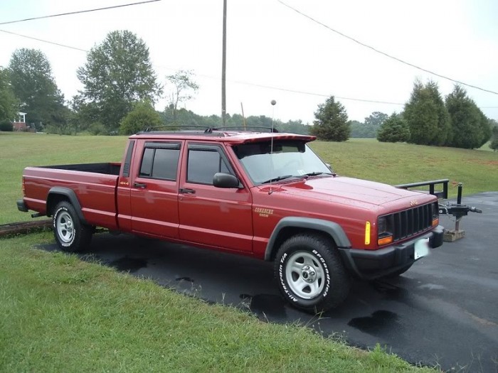

Doc. Posted December 4, 2015 Author Posted December 4, 2015 johnj92131, that is what I keep coming back to for the most logical option. Just wish I had some nice doors from a 97 up XJ 2 door. I a rusty 2 door and measured them and compared to the MJ doors, forgot what the difference was though. I do have a rusty MJ for the extra roof section too. I think I have it worked out in my head for the floor. Would be nice to see a photo of one done that way to see how it would look. This? Yah, I don't think so.
Eagle Posted December 4, 2015 Posted December 4, 2015 johnj92131, that is what I keep coming back to for the most logical option. Just wish I had some nice doors from a 97 up XJ 2 door. I a rusty 2 door and measured them and compared to the MJ doors, forgot what the difference was though. I do have a rusty MJ for the extra roof section too. I think I have it worked out in my head for the floor. Would be nice to see a photo of one done that way to see how it would look. I believe this one has 2-door doors:
mikekaz1 Posted December 4, 2015 Posted December 4, 2015 johnj92131, that is what I keep coming back to for the most logical option. Just wish I had some nice doors from a 97 up XJ 2 door. I a rusty 2 door and measured them and compared to the MJ doors, forgot what the difference was though. I do have a rusty MJ for the extra roof section too. I think I have it worked out in my head for the floor. Would be nice to see a photo of one done that way to see how it would look.I believe this one has 2-door doors: I thought this was deemed a photo shop?

martin809 Posted December 5, 2015 Posted December 5, 2015 johnj92131, that is what I keep coming back to for the most logical option. Just wish I had some nice doors from a 97 up XJ 2 door. I a rusty 2 door and measured them and compared to the MJ doors, forgot what the difference was though. I do have a rusty MJ for the extra roof section too. I think I have it worked out in my head for the floor. Would be nice to see a photo of one done that way to see how it would look.I believe this one has 2-door doors: I thought this was deemed a photo shop? This is photo shopped. He did many different variations..
Eagle Posted December 5, 2015 Posted December 5, 2015 This is photo shopped. He did many different variations.. I didn't know it was 'shopped. Even so, it shows what an MJ would look like if stretched to accommodate 2-door XJ doors, and that was the question to which I was responding. Nice 'shop job -- one of these days I need to learn Photoshop.
Crash Posted December 5, 2015 Posted December 5, 2015 This is photo shopped. He did many different variations.. I didn't know it was 'shopped. Even so, it shows what an MJ would look like if stretched to accommodate 2-door XJ doors, and that was the question to which I was responding. Nice 'shop job -- one of these days I need to learn Photoshop. There are a couple pictures of that truck, if you look below the truck at the driver rear tire that it was not edited correctly. Not that specific pic mentioned, but others of that truck.

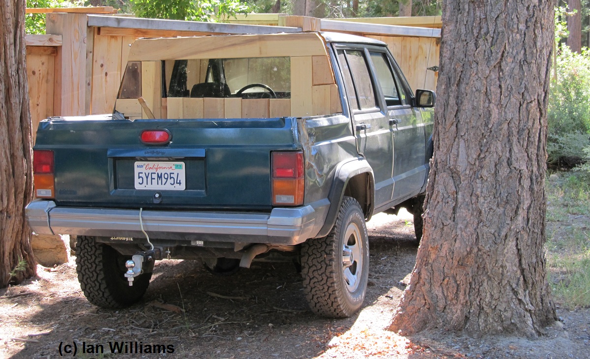

Lowrange2 Posted December 5, 2015 Posted December 5, 2015 Honestly, I think it'd be pretty silly to build an Extended cab MJ when you could easily chop the back off of an XJ, close it in and build a tailgate with MUCH less effort and end up with basically the same thing.
johnj92131 Posted December 5, 2015 Posted December 5, 2015 Honestly, I think it'd be pretty silly to build an Extended cab MJ when you could easily chop the back off of an XJ, close it in and build a tailgate with MUCH less effort and end up with basically the same thing. It depends on your point of view, doesn't it? I see jacked up trucks driving down the street and I think they look very silly. Not to mention when you see one of these lifted trucks in an accident. I see lowered cars with air bags and I wonder what is the point of going down the street with 1 inch of road clearance. No way to get a decent size bed on an XJ conversion. Also, XJ conversion lacks the proper factory transition to a cargo box frame. The XJ conversion is just a weakened unibody structure with the top cut off. So if you want to convert an XJ to a truck the "proper" way - you should follow the example of the factory engineers. I am quite sure they did the math. Seriously Lowrange2, don't you think if it were just as simple and easy as you propose, the factory would have done it your way? They must have had good reason to do it the way they did - don't you think?
