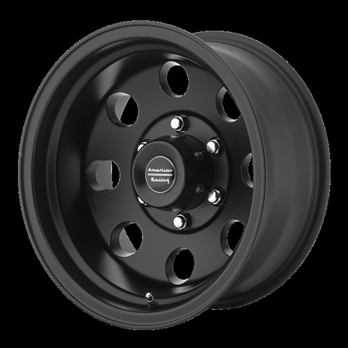

Jeep Driver Posted January 31, 2015 Author Posted January 31, 2015 Typical but acceptable.....I guess.....

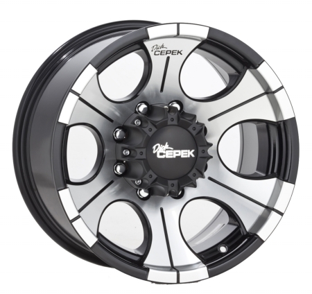

Jeep Driver Posted January 31, 2015 Author Posted January 31, 2015 I actually like these....but 20" and 5 on 5

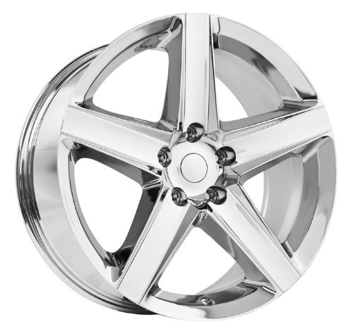

Jeep Driver Posted January 31, 2015 Author Posted January 31, 2015 I really like these.....but 18"........what tires size?
Eagle Posted January 31, 2015 Posted January 31, 2015 The typical 32 is a 32x11.50-15. Actual diameter is slightly less than 32, more like 31.7", and width at the sidewalls is about 11.4". 11.4" is 289.56mm. Call it a 285 for nominal tire size purposes (slightly narrower), or bump it to 295. Using 285 as the width, then we have to figure the aspect ratio. Were looking for an overall diameter of 32". Subtract 17" and that leaves 15 for the tire, and then divide by 2 to get the cross section height: 7.5", which is 190.5mm. 190.5 / 285 = .668. So in a 17-inch tire you're looking for a 285/65-17. I have no idea if such a tire exists. In a 16-inch tire size, a 285/75-16 is 32.8" in diameter (basically a 33) and 11.2" in cross-section width. Call it a 33x11.50-16.
