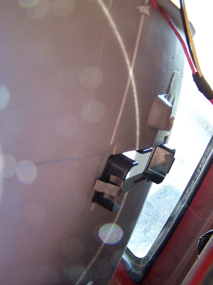

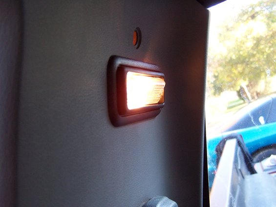

JeffK Posted February 14, 2010 Posted February 14, 2010 This is copied of part of my build thread. I found out after I posted this that 91MJDude had found these lights as well, he suggested doing a write up so everybody else could find them. I've been obsessing over this B-pillar light. Stock replacements are impossible too find or expensive. I thought using the same Led's woodkrawler (jeep forum member) used... but I really wanted something that would snap into the factory hole. I found these VW lights and the fit the hole fairly well... but I just didn't really like them. I'm not sure exactly what I was looking for, but I was doing a image search on Google and stumbled on this picture... It's an aftermarket replacement interior light that's marketed for Hot Rods and custom cars. Made by a US company called Euramtec. I found their website and downloaded the spec sheet on the lights. You can see from their measurements it's almost identical to the factory MJ lights... After about a half hour of searching, I found a site that sells classic car lenses and they had a listing for them. I got both of them for $35 shipped. Compared to the VW lens... I painted the trim and fitted the new lights... Mods to the trim was minimum. The height of the new light was perfect, and I had to file about a 1/16 of an inch of material to make them fit length wise. Fitted... I really like the way they look installed and as an added bonus the function of the new lights is the same as the factory. UP - on/off with the door Center - off Down - on/map light :cheers:
jpnjim Posted February 14, 2010 Posted February 14, 2010 Looks good! How is the 'action' on them? Do they feel like the stock switches (OK, but borderline cheesy), or more substantial?

JeffK Posted February 14, 2010 Author Posted February 14, 2010 For a plastic (sorry fiberglass reinforced resin) light, they are surprisingly well made the action on the switch is as good as the best factory one I've seen. The back. The switch mechanism. Lens in the up position. Middle. Down.

socal1200r Posted February 14, 2010 Posted February 14, 2010 The only problem I see with those Euramtec lights is they still use those funky old-style bulbs. I replaced the stock b-pillar lights with some universal rectangular interior dome lights, and replaced the stock incandescent bulb with a 3-LED bulb, and boy do those two lights do a good job of illuminating the interior! But you did a GREAT job in finding those Euramtec lights, and painting them to match your panels. Very stock looking, and at first glance (and second and third!), I doubt anyone would know they're not stock MJ lights. Nice find and great writeup!
