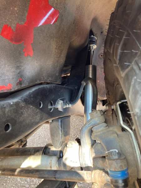

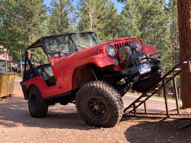

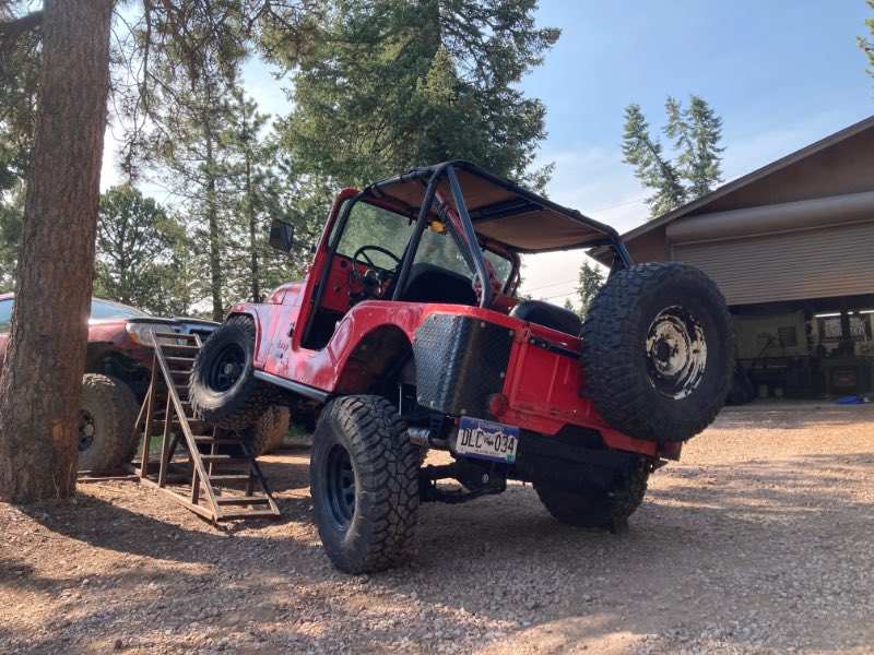

  1. Quite the before and after! It is SO satisfying when a project gets wrapped up and everything just works! I could’ve gotten higher on the ramp but I ran out of traction. Next on the list should really be a front locker to go along with the rear limited slip. The rear shocks are sized perfectly but the front are long enough that they definitely leave some travel on the table. That’s okay though! Without inverting the leafs, thats about as you can push a set of YJ springs. Road manners will take some getting used to that it’ll lean over much more than it did if you really push it around a corner. Otherwise, the ride quality is great for what it is! We’ll see how these cheap springs will last but I think the Bilstein shocks were the right call. I really need to get this on a trail.

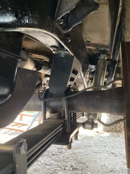

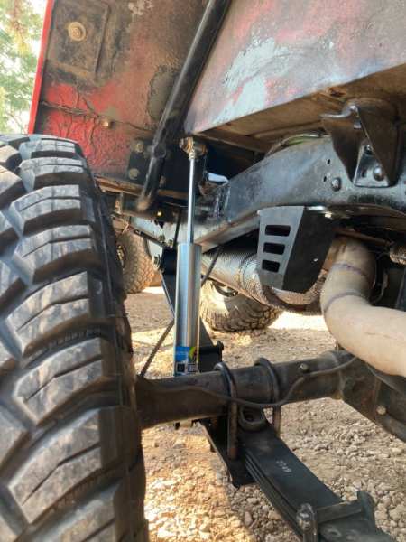

  4. I took the weekend off from CJ things. Back on to the rear today though. All of the brackets came off just as easy as the fronts, however I will forever be (rightfully) skittish using a torch around a fuel tank. For the rear shackles, I reused the old ones but cut out the center stiffener and drilled them out for 9/16” hardware. Bump stop measurements went the same as the fronts too. The axle got jacked up until the majority of the spring was flat and everything else was set from there. I did notice that the rear has some flex steer that pushes the axle towards the rear. The body/inner fender got trimmed for a little more clearance. We’ll call it rust removal. There’s plenty of room for shocks in the rear compared to the front, but I didn’t like how the factory upper mount would’ve made the shock hang down if I had kept it like originally planned. The pocket the upper mount lives in between the frame and the body leaves enough room to push it up some. The pinch seam got a little notch in it similar to how early Broncos do to get the shocks higher. Otherwise, the lower mount is just a stud welded to the spring plate. Moving right along. Maybe done tomorrow?

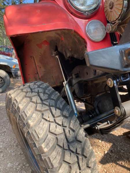

  13. Almost… I almost got the front suspension done today. On the very last hole I needed to tap for the bump stops, the tap broke off in the frame and I ran out of gumption. Anyhow… I wanted to start with finalizing the bump stops based on the leaf springs. These are extended Cherokee bumps and they were the perfect length for when the spring is mostly flat through the majority of the spring. This does leave some up travel on the table, but I don’t want to damage the springs over time. The tire tucks up about 1.5” further than it did with the old springs. Cycling the suspension after I cut the fenders and tacked in the upper shock mounts, I found that I was running out of room quickly! I must’ve moved the upper mounts a half a dozen times before the shock body wouldn’t contact the frame at full extension with the other side all the way up. It’s close! The lower mounts also got reworked in order to tuck the shocks closer to the frame since the caliper wanted to share the space also. Clearance was needed there too. More cycling and compromises were made. The tire has always contacted the frame at full lock in the front. Now that there’s a much larger shock and mount in there, the tire does contact it at full stuff at full steering lock. I thought about cutting out the upper mount yet again to tilt the top more vertical, but there wasn’t anything to gain unless I moved the lower mount also and ground more off the calipers. At ride height, the steering will let the tire go to full lock with a half inch to spare to the frame. I’m thinking wheel spacers are in the cards now. Probably 1” in the front and 1.5” in the rear. After looking at it and cycling, and then looking at it more with more cycling, I decided that everything is where it’s going to live. After painting everything was when I realized I didn’t drill and tap for the bump stop mounting… then the tap broke… then I spent the next half hour getting it out. I’ll let the paint dry tonight and come back tomorrow.

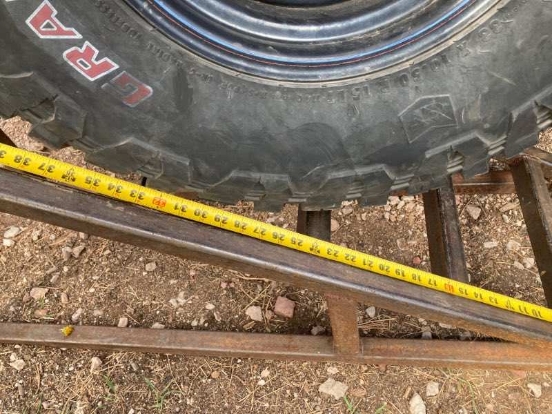

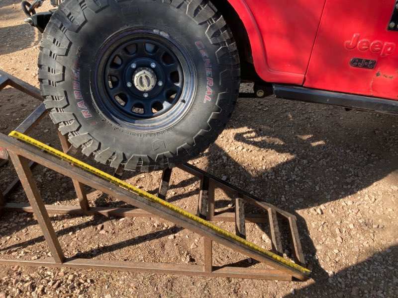

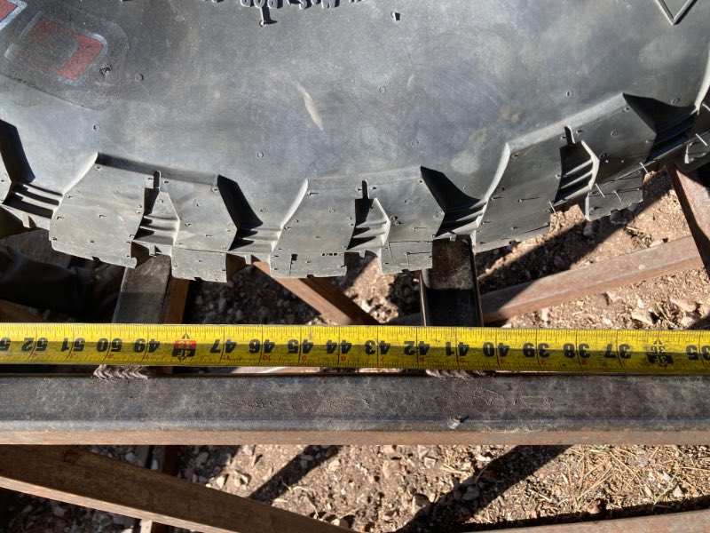

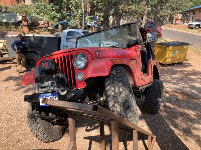

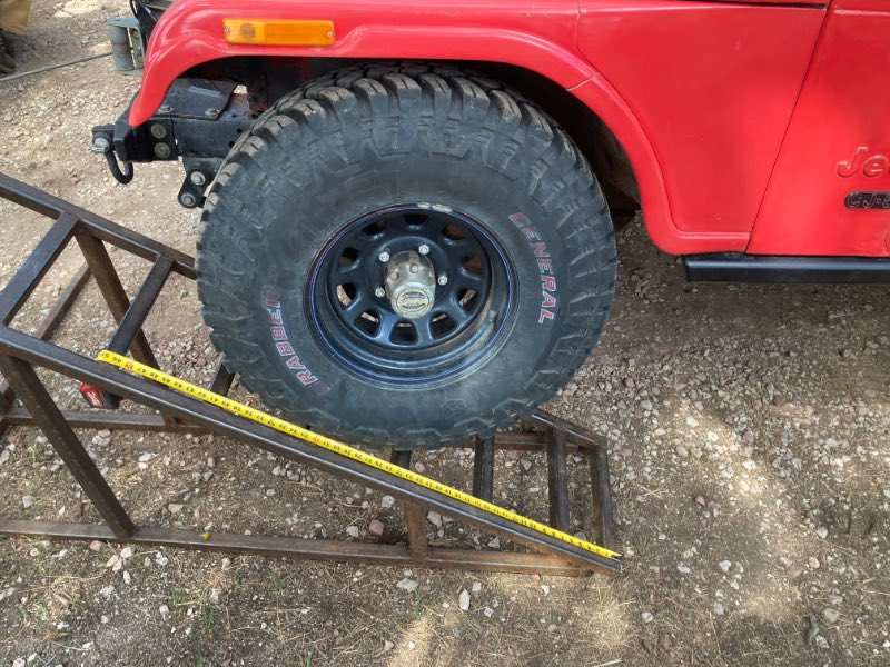

  16. Crazy mad flex! I ran the CJ up my buddy’s ramp today to get some more baseline measurements. Unfortunately, I ran out of traction before lifting a tire so the winch got used to pull it up the rest of the way… very embarrassing. Let’s talk about the rear. With the rear tire bouncing off the ground, the shock was about topped out at 19” of travel. At the other side, the tire was just about into the wheel well and I wasn’t even close to the bump stop. As for the front… … I also have a mile or so before anything touches anything. The shock bottomed out before the tire was anywhere near full stuff. Pretty sure there’s some room for improvement here.
