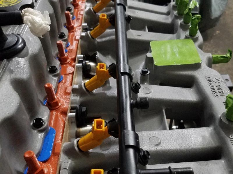

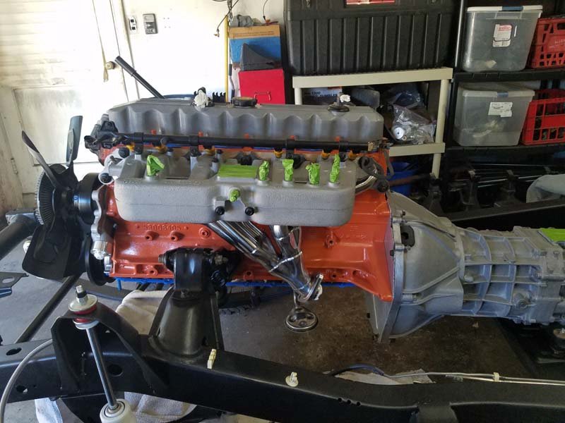

OK, you pretty much sold me with your post. I'm sending this back. I'm not even sure on exact downpipe fitment and just thinking about modding then coming into a downpipe issue is going to make me go insane. There's no way I'm grinding on my stock intake. So, this is going back. Any recommendations on headers known to fit an HO 4.0L without problems or clearance issues? Jeep Driver recommend Banks or AFE but that pricing is a little salty. I'd do it if that's what's got to be done, though. I've already heard Pacesetters have fitment issues, so they're out. -

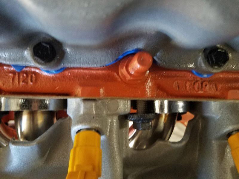

I'm almost to the point where if I could guarantee fitment without modification, I'd pull the trigger. And based on your responses concerning my issues, and my own feelings, I think this header is going to be returned. This header is supposed to fit with both the earlier square intakes like mine, as well as the later horseshoe intakes, according to the manufacturer. Reviews indicate the header was likely manufactured based on the square intakes as there were fitment issues reported with the horseshoe versions (guys had to dent tube 4 I believe). There were hundreds of excellent fitment reviews on this, and people talking about great welds and minimal bluing. Looks like a good unit, but it is what it is. I was hoping for a good one, I guess. -

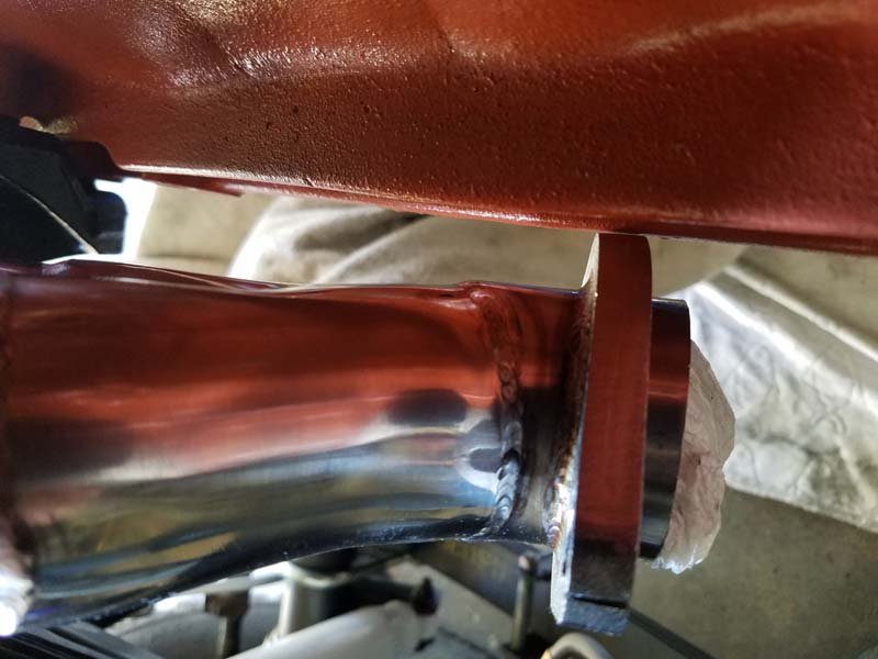

Thanks for the input. Hearing the height difference looks minimal is good to hear. It is minimal maybe 1/32" off, but those washers are not at 90 degrees as they should be. Being not-a-mechanic, I don't know if what I'm looking at here is normal (and why step washers are used by the factory), or if what I'm seeing is a bad thing. I have room to grind that output flange up to 1/8" before I run into what would be the mounting surface for the output gasket. I'm just not sure if 1/8" of clearance is enough if I do grind. I checked downpipe against the output and it's significantly smaller in diameter, matching the stock output flange's size. Both the stock manifold and this header look to dump in the exact same location, give or take 1/4". I'm using the stock downpipe, and could cut weld it's mounting bracket to any location I want, if fitment is off at all. The rest of the exhaust will not be mounted until this header situation is straightened out. -

If you mean the output gasket that the downpipe fits over, I have no idea. The header came with one, and I have a Crown OEM replacement, and they're both the same. The output flange on the header (the piece the downpipe connector bolts through) has a bigger outer diameter than stock, so I could grind that to increase clearance, but I'm not sure if I can get more than 1/8" or so out off of it. The output pipe and gasket fitment are fine. It's just that the output flange is nearly rubbing the block. -
