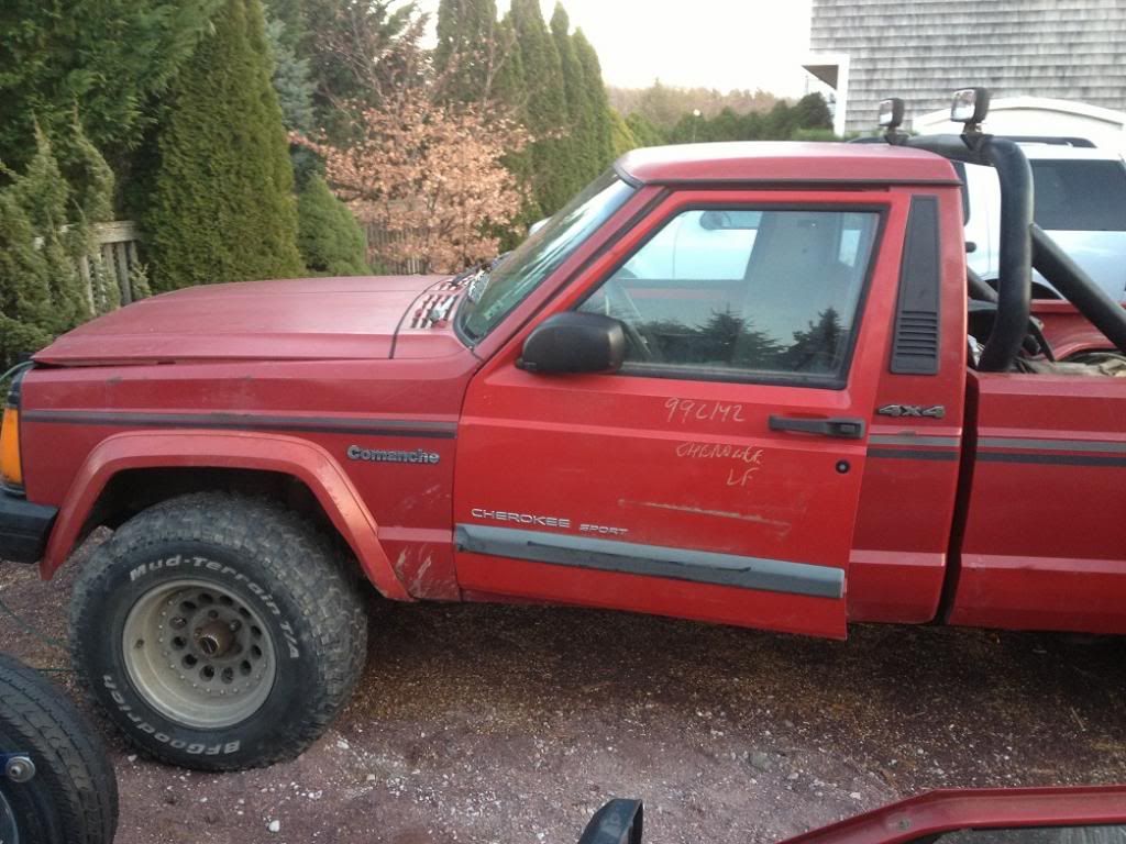

How's everyone doing, I'm new to this forum and finally bought a comanche after searching for a few months. I've owned a few zj's and have a xj as a dd currently. I have high hopes for this build and we shall see where it takes me, can't say I have a budget since its a JEEP
Bought it from a member here on CC for $900 and got beat up on the shipping costing me a total of $1525 to my door. Needs a trans seal to get it running ( trans in bed )
Specs
1990 comanche pioneer lwb
174k auto 4x4 355 gears
Solid frame
Newer engine with 85k
Roll bar
Needs rockers and some body work
Here are some pics
My xj in the background
Took the bench seat carpet and some trim out
What a pitta the lower seat belt bolts are
Mostly surface but has a couple poke through spots on the drivers side
Passengers side mostly surface and nothing too major
Comanhe- $900
Shipping- $625
Cost to date- $1525

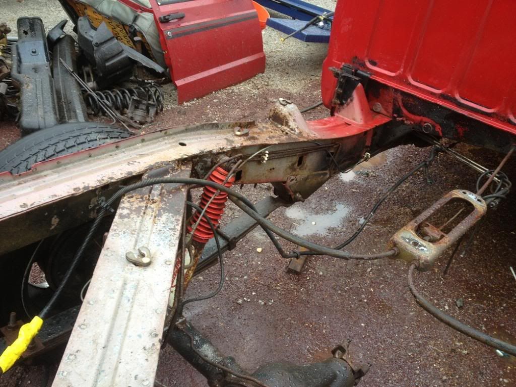

Happy to say the frame is rott free with some flakey undercoating and minor surface rust
Posted Image
Posted Image

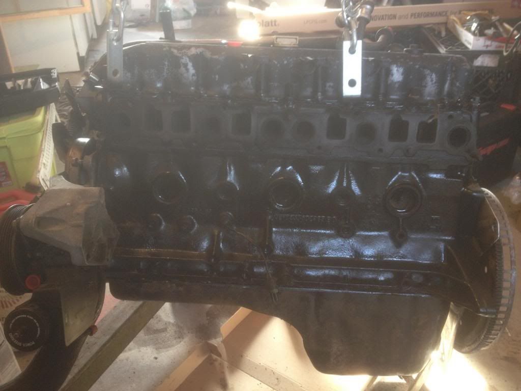

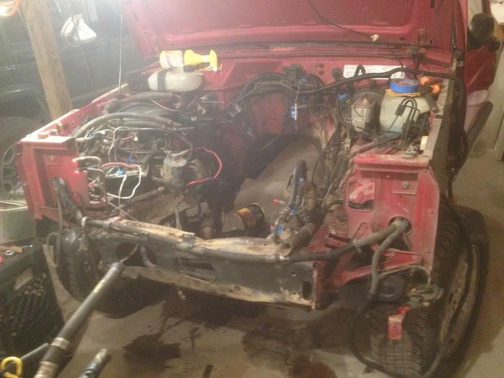

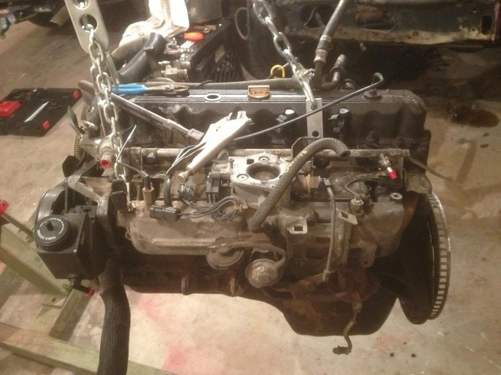

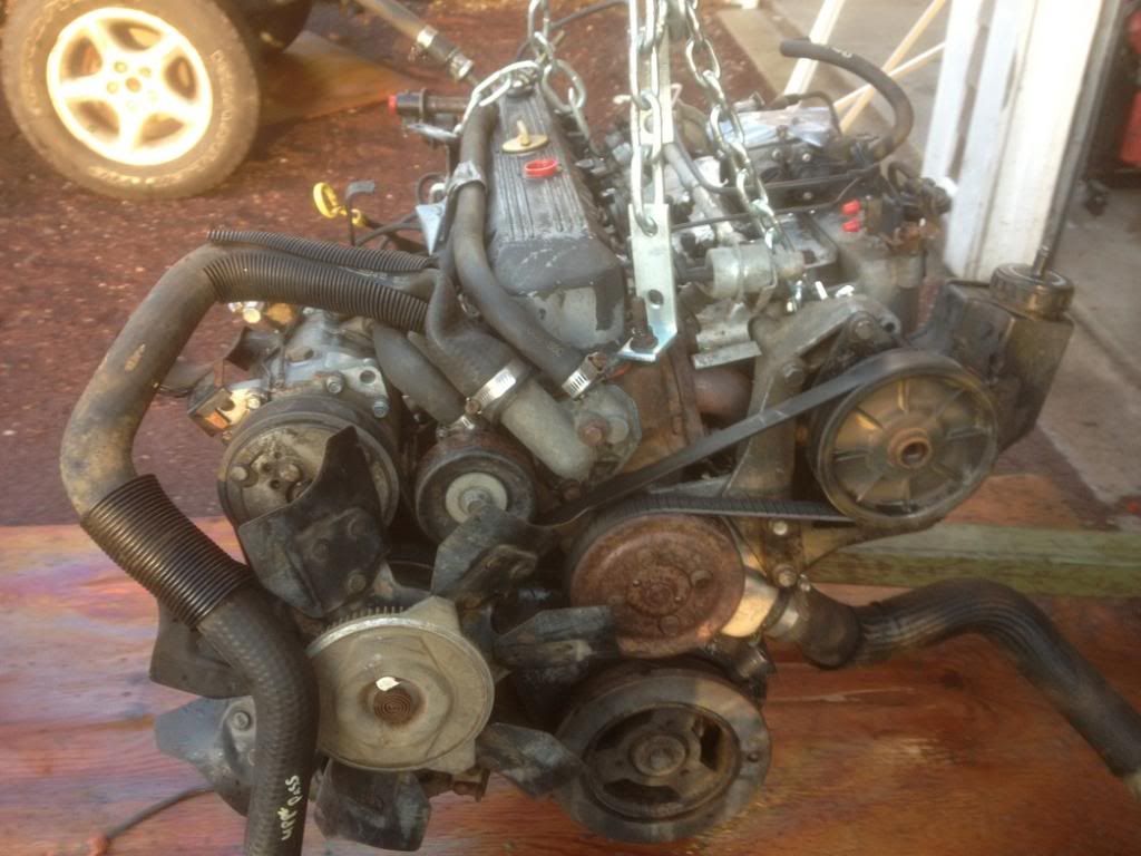

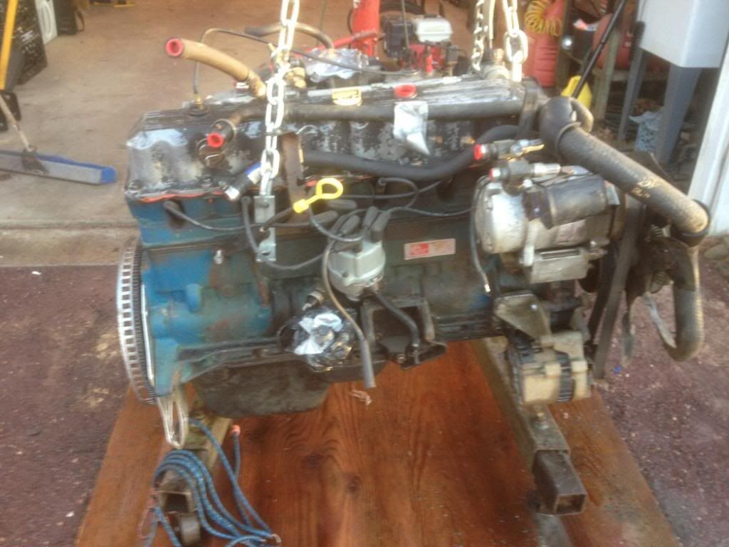

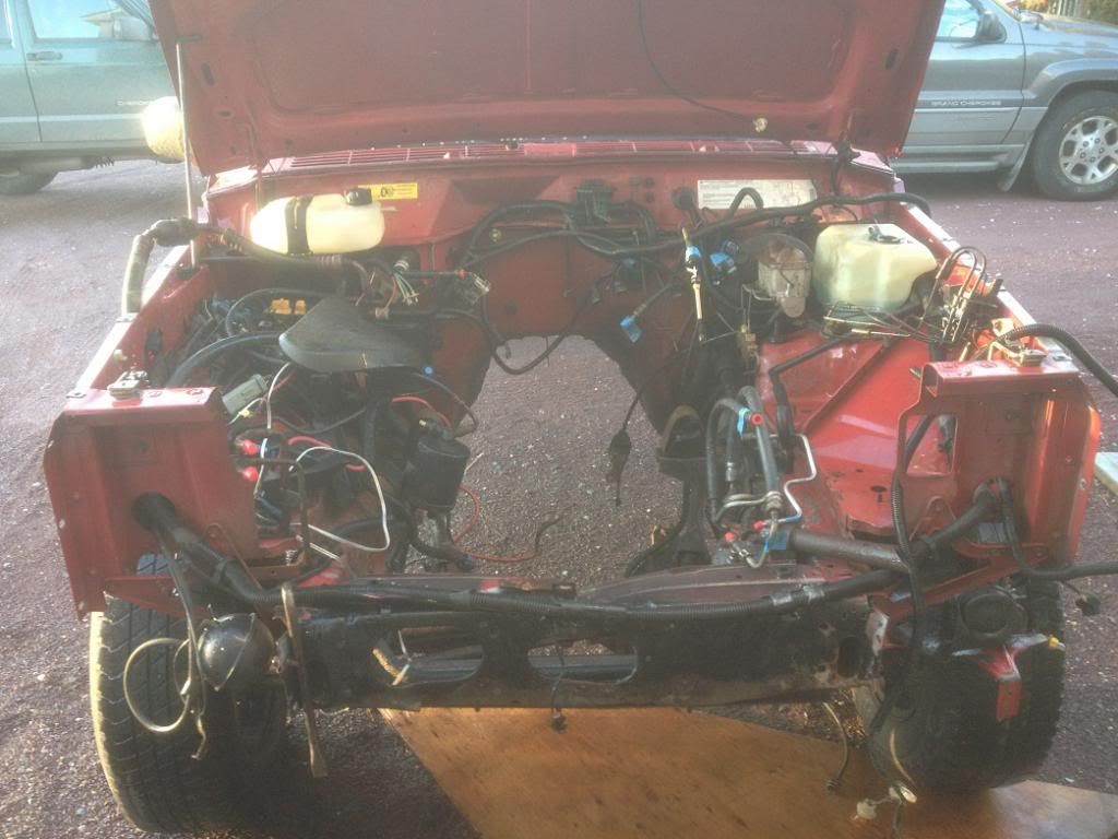

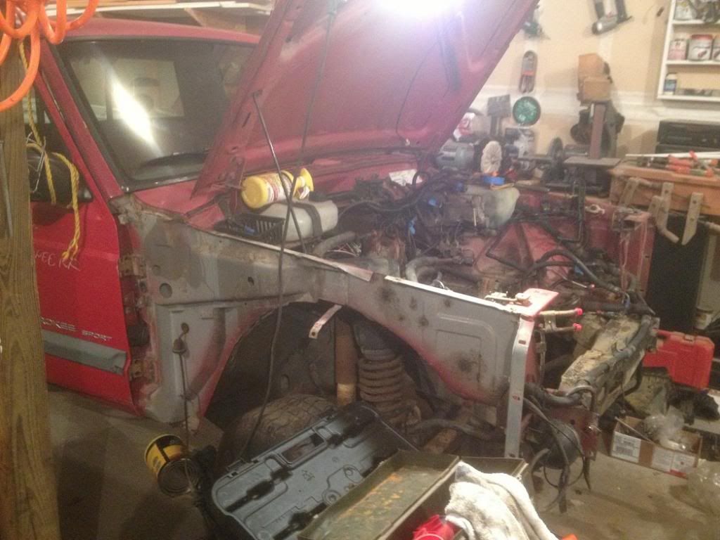

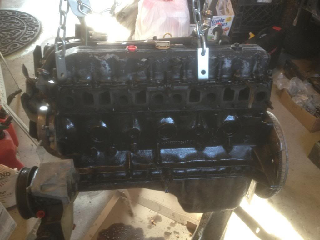

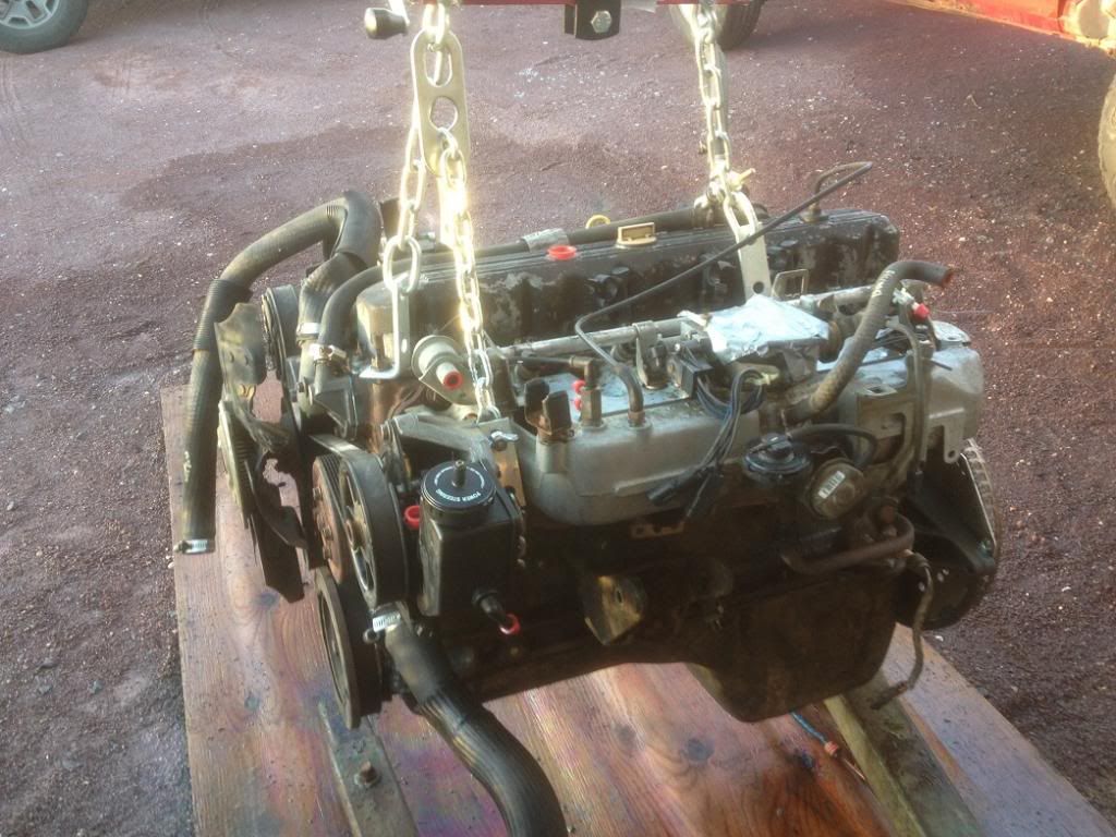

Been awhile since ive updated my build, Stripped the front end of its sheet metal 2 weeks ago, and Finally made some real progress last weekend and got the engine pulled, figured it would be easier to replace the exhaust manifold, motor mounts ect and paint the engine bay with the engine out the way.
First time pulling a motor and it went fairly good with a few broken items but nothing too major
Posted Image
Posted Image
Posted Image
Posted Image
Posted Image
Gave the engine a quick bath and who would have knew my block is blue lol
Posted Image
Posted Image
Posted Image

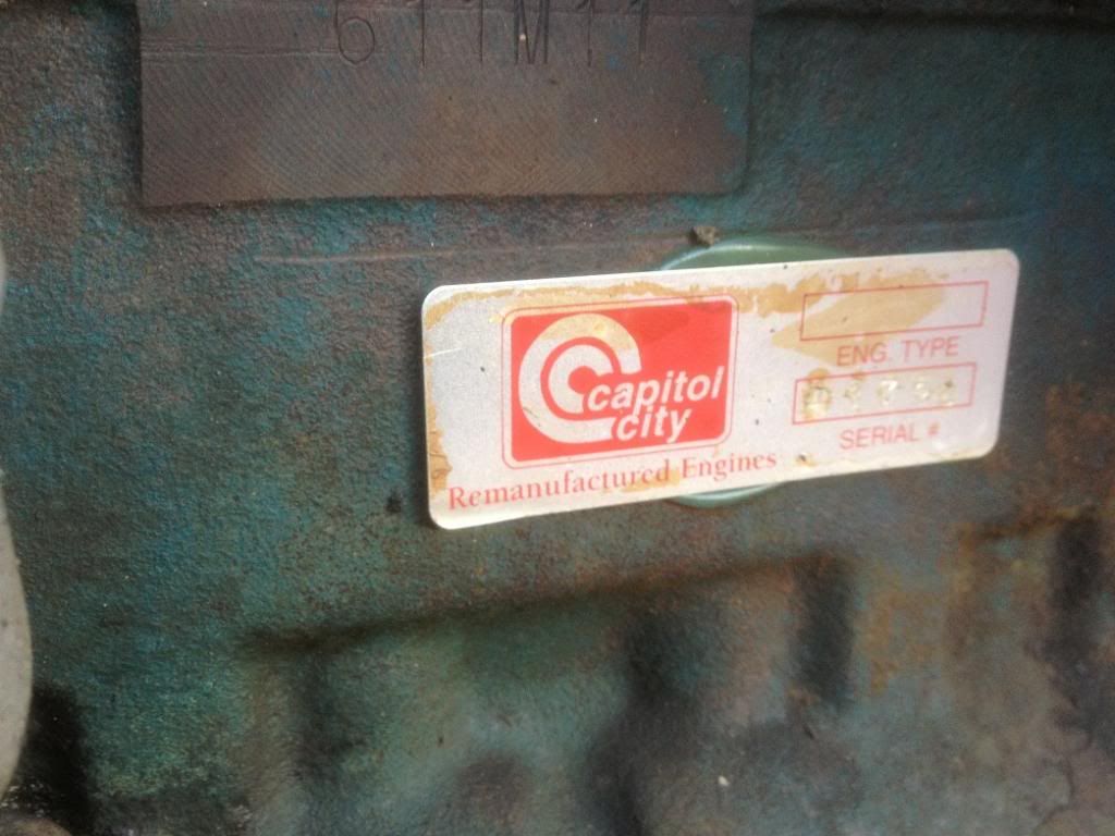

Been a little nervous putting all this time and money into this engine that i never head run since the trans was in the bed when i bought it.
Takes a small edge off of things knowing it was rebuild at sometime
Posted Image

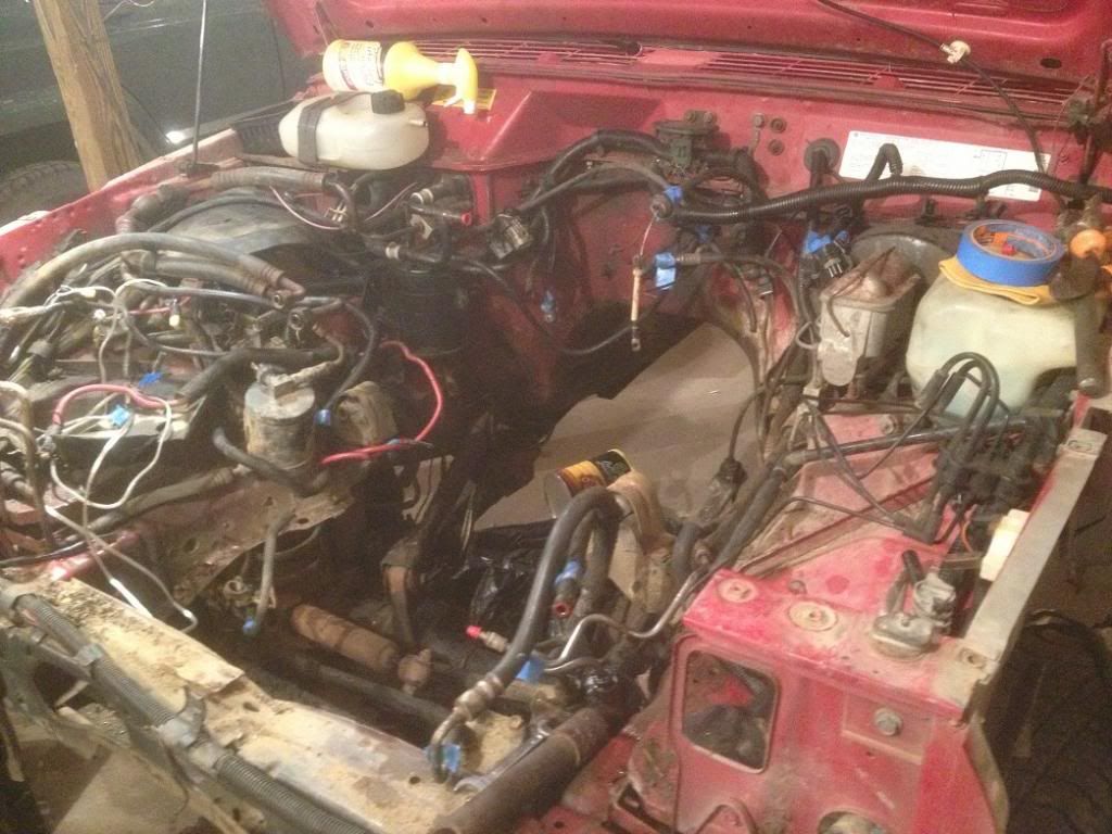

And the engine bay after a pressure wash
Posted Image
Tomarrow i will start on replacing gaskets and some engine goodies :) more pictures to come tomarrow

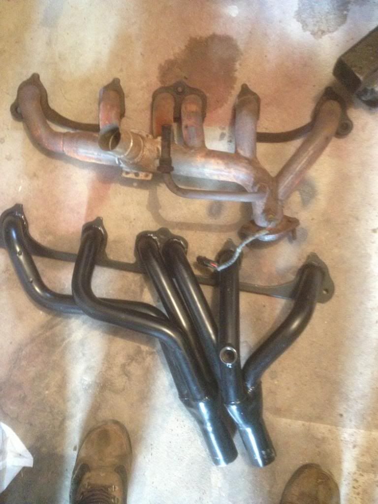

Starting to clean up the motor one side at a time, Got the intake and exhaust manifold pulled ( to my suprise all the bolts came out very easy )
Posted Image

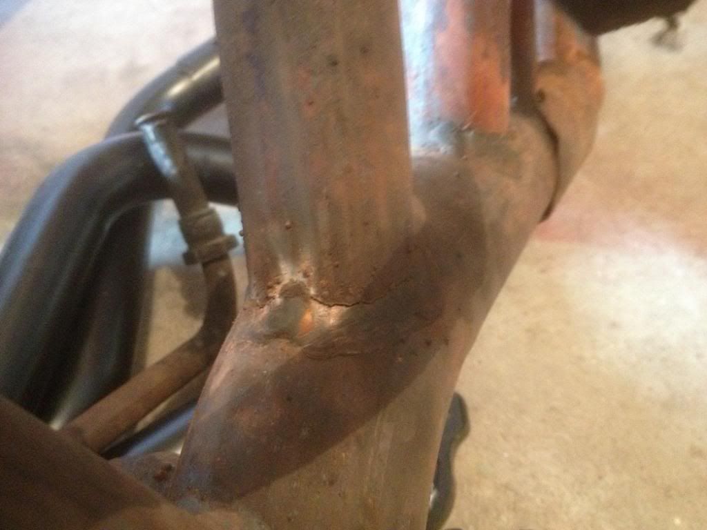

Knew the exhaust manifold was cracked and prevously welded a few times
Posted Image

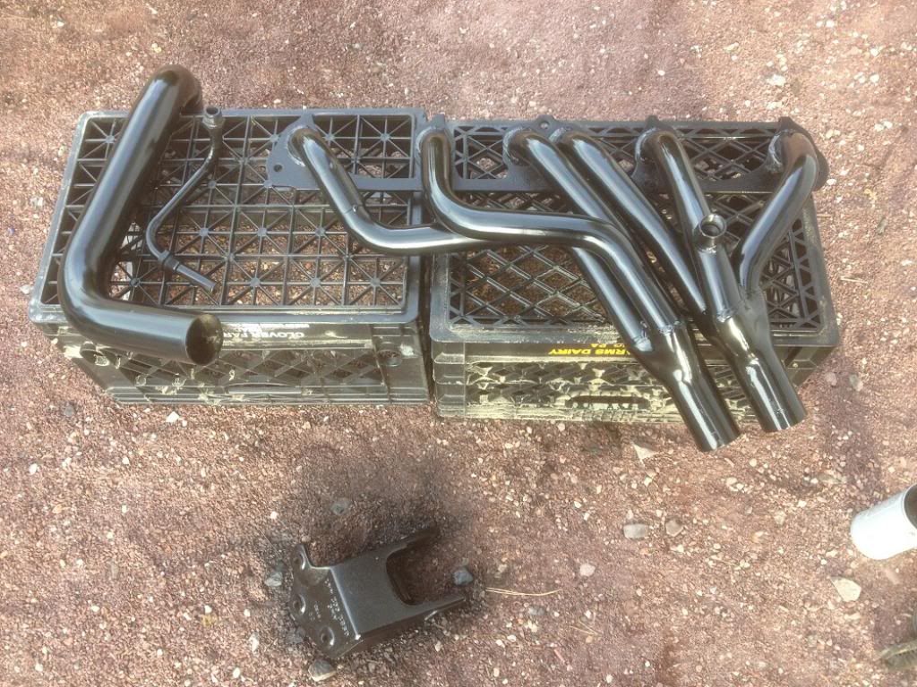

Time for an upgrade, picked up some pacesetter headers off ebay a few months back for $147.50 shipped
Posted Image

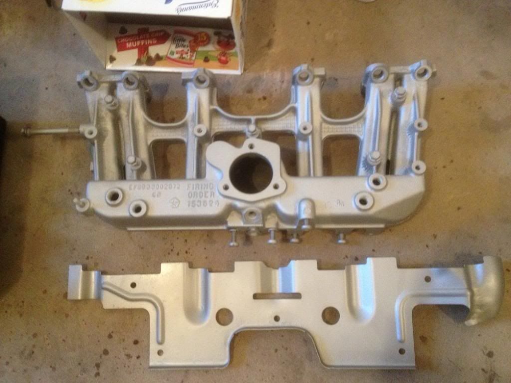

Quick coat of paint since they had some paint chips from being moved around. ( also painted the motor mount )
Posted Image
Cleaned and painted the intake manifold and heat shield

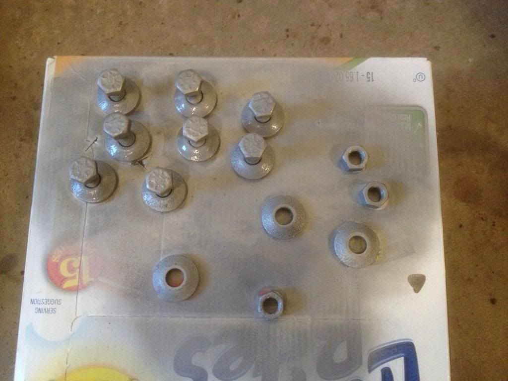

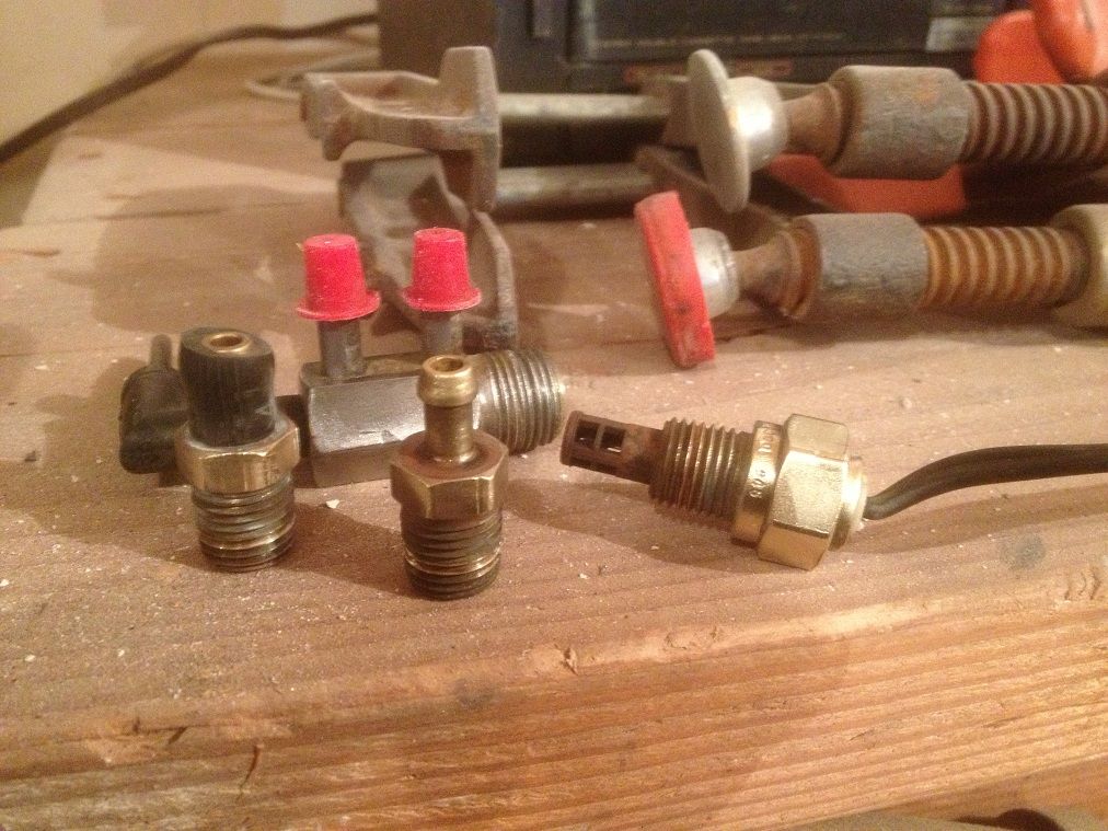

Painted the bolts and will have to swap the washers with the new ones that came with the headers ( forgot all about them till i called it a day )
Posted Image
Shinned up the brass fittings with a wire wheel
