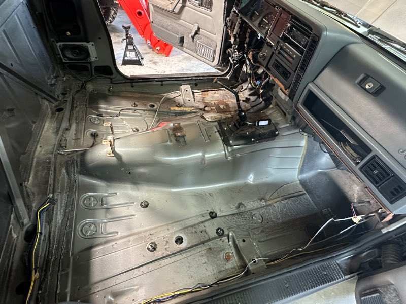

OzarkGuy Posted August 3 Posted August 3 I've been tinkering with the truck as weather permits. Truck sits in a metal shop so if it's 90º out, its about 130º in the shop so its been slow progress. I replaced the padding, put new shifter spacer where mine was disintegrated along with new rubber shifter dust cap. Can't believe that change alone and how it made the shifter feel so solid again. I had sent out the seatbelts to get new webbing as mine were just disgusting from age. All new LED bulbs and painted the bare rusted under dash metal parts flat black. Looks like a new under there. I also replaced my steering column as it was all jacked up. Super happy I can turn the key to accessory to listen to the radio and have wipers work again let alone high beams! Hopefully I will get the seats back this week. We bought a 2024 Model 3 Tesla and that car has been fun to drive. My wife needed a new set of wheels and since it can drive itself, she is happy.

fiatslug87 Posted August 3 Posted August 3 Looks good! I think you have your shifter boot rotated 180°, the high part at the bottom should be towards the dash.
OzarkGuy Posted August 3 Author Posted August 3 8 hours ago, ghetdjc320 said: @boxyjeep has a nice setup: https://boxyjeep.com/products/jeep-cherokee-xj-ax-15-tunnel-cover-1984-2001 Thank you! Yes, that is the tunnel boot but this one is the shifter kit. I did replace the tunnel boot with the one linked. https://www.amazon.com/dp/B0BX67SZ3M?ref=ppx_yo2ov_dt_b_fed_asin_title

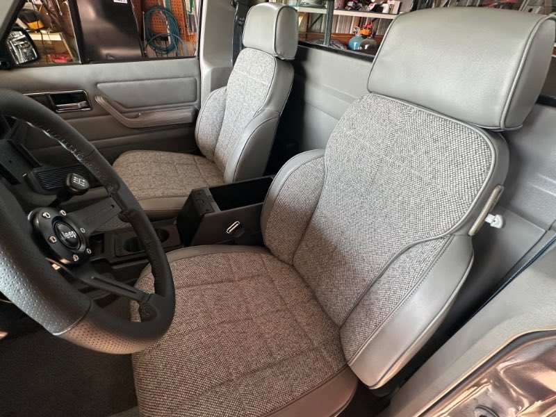

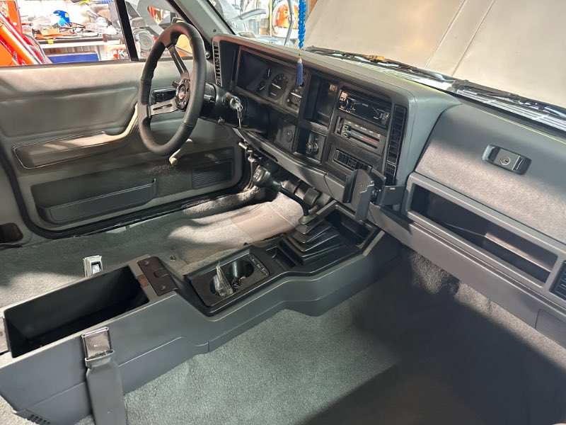

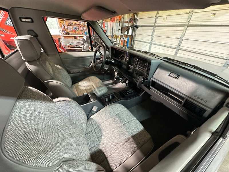

OzarkGuy Posted August 12 Author Posted August 12 Seats are back in and they look awesome. Took the truck out for a drive after it has been sitting idle for almost 2 months. It all feels great! The console lid was crappy so I ordered another on eBay. It arrived today and it completes the look although these pics are before I installed it.
ghetdjc320 Posted August 12 Posted August 12 Looking good! I’m in the middle of some interior work as well. Btw, @Dzimm makes some console replacement latches if you need them. Upgraded design over stock
OzarkGuy Posted August 12 Author Posted August 12 9 hours ago, ghetdjc320 said: Looking good! I’m in the middle of some interior work as well. Btw, @Dzimm makes some console replacement latches if you need them. Upgraded design over stock Thank you! I'll look into it. My console has a piece of plastic broken off where the lid latch would hold on to. Haven't delved into that yet.
ComancheX2 Posted August 12 Posted August 12 That looks nice! I have to say I prefer the pre-97 center console that you used as compared to the 97+ the prior owner(s) used for mine. For me, it just looks right. But then again my first vehicle was an HO era XJ. So I'm probably biased!
OzarkGuy Posted August 12 Author Posted August 12 What does the 97 console look like? I would have loved having the handbrake in the console rather than the footwell.
