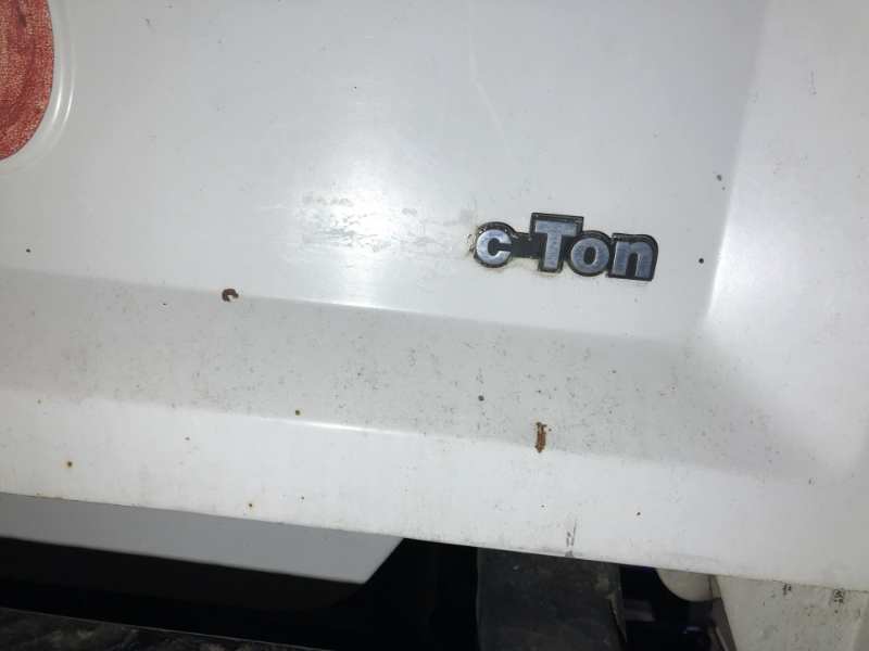

Notes: Hoping to find out if this truck was suppose to have the Dana 44 or not. There is a broken emblem on the tailgate that I'm guessing came with the "MectricTon" package.
Definitely a metric ton badge, so it should have a D44. That said, after nearly 330,00 miles and 34 years, the only way to check for sure would be to crawl under it and inspect.

This is not a Metric Ton, the fourth position would need to be a "G", also the HO years would not have a metric ton emblem it would have a Big Ton sticker in the  passenger side back glass. It is a Pioneer.

Sad to see it's not a Metric Ton.
