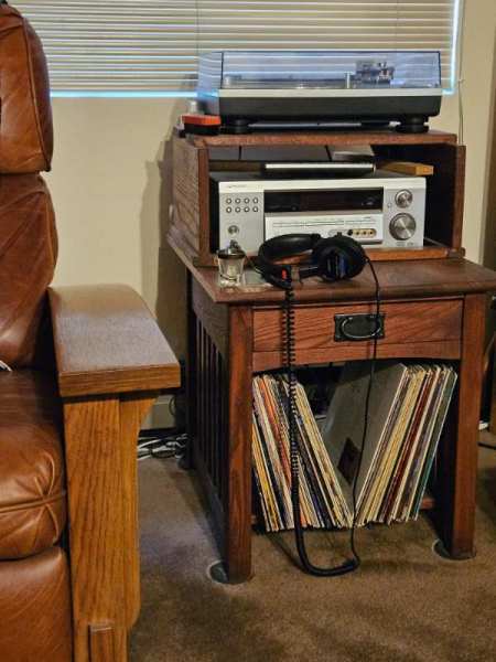

3 hours ago, rokinn said:
What kind of system do you have? Quartz lock, variable pitch adjust, belt driven?  Just a few variables to be considered.  Which brand and model would help narrow it down a bit.
Its a technics sl 1500.
  • Replies 51
By appearances it looks to be the Mk1.  I would start by re-cleaning the speed pots.  From what I can gather they seem to need it periodically.  Beyond that it could be an issue with the servo control motor or connections.  Looks like a nice TT.
