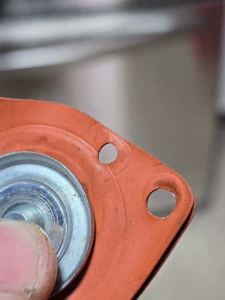

  25. So just to follow up, found the issue. I rebuilt the throttle body as soon as I got the jeep so didnt think this would be the issue. As a hail Mary I went to rebuild the fuel regulator and found this Turns out it was filling the whole thing with has through the breather and I think pouring gas into the Throttle body through the air hole. What a pain
