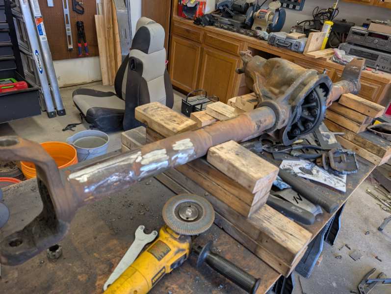

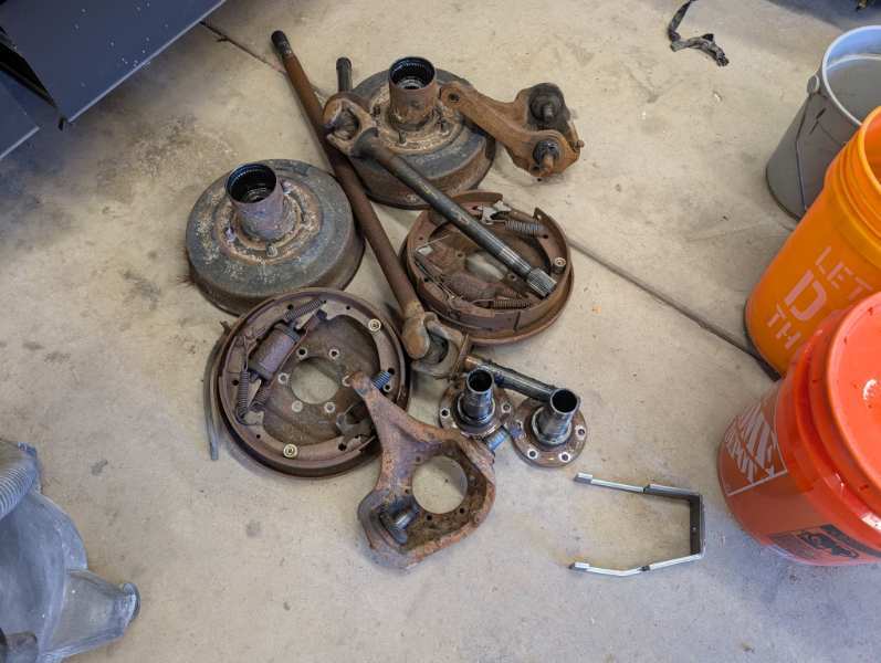

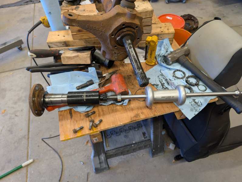

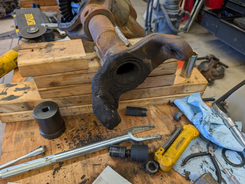

I do have to say  having the right tools at hand makes working on 50 year old axles so much nicer...
Outers are disassembled.  Everything from the ball joints out were going to be replaced anyway.
The knuckles for the drum brake Ford are different than for disc brakes.  But I am upgrading to Reid high steer knuckles anyway.  The spindles are different too.  I would have kept the originals but that wasn't an option.

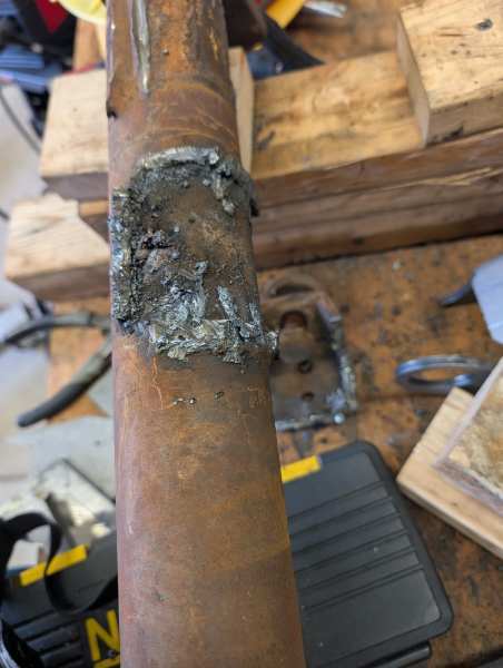

Time to finish cleaning off the tubes.  I need to get the rest of the slag ground down and remove the track bar bracket.

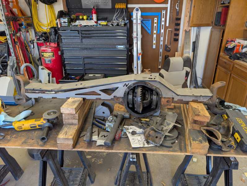

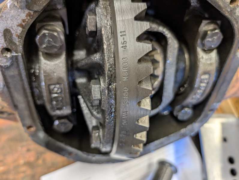

I did confirm it is factory 4.09 gears.  Not quite enough gear for 35s.  So they will get bumped up when I install the locker.

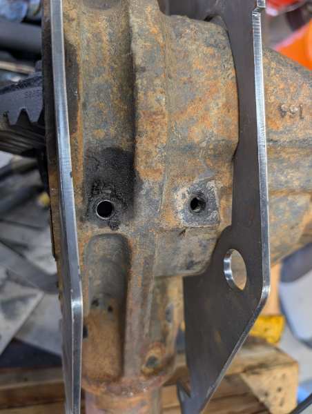

The truss basically fits.
But there's a minor problem with the breather...
I had to do some minor trimming on my housing to get the truss to fit. My housing had this extra rib on the back and then the leaf spring pad. Excited to see how it turns out!

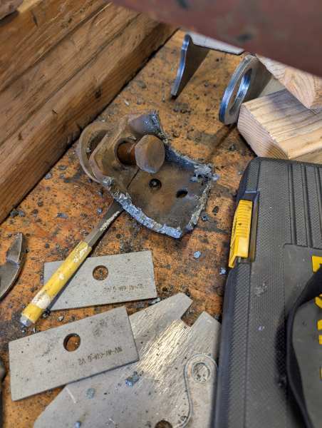

I expect that I will need to trim somewhere.
There is another hole in the top of the housing.  It had a bolt that held on the brake line tee.  I'm going to see if I can hijack that for the locker line.

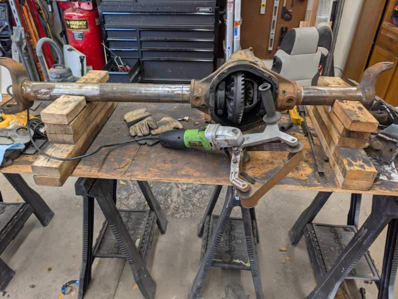

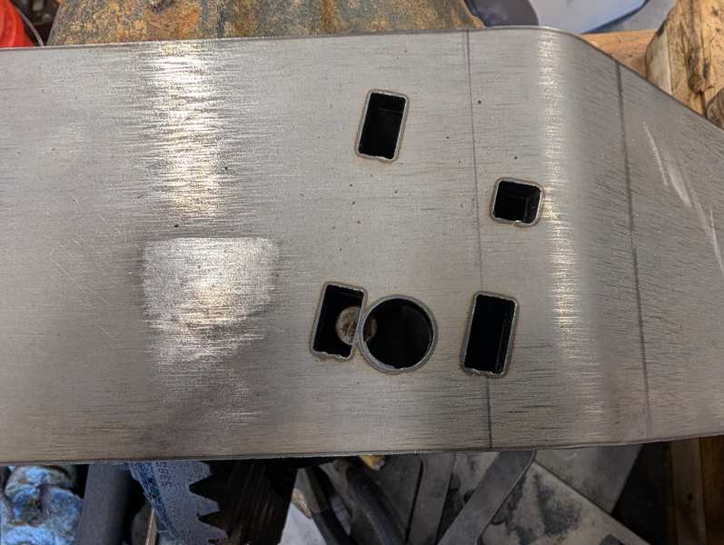

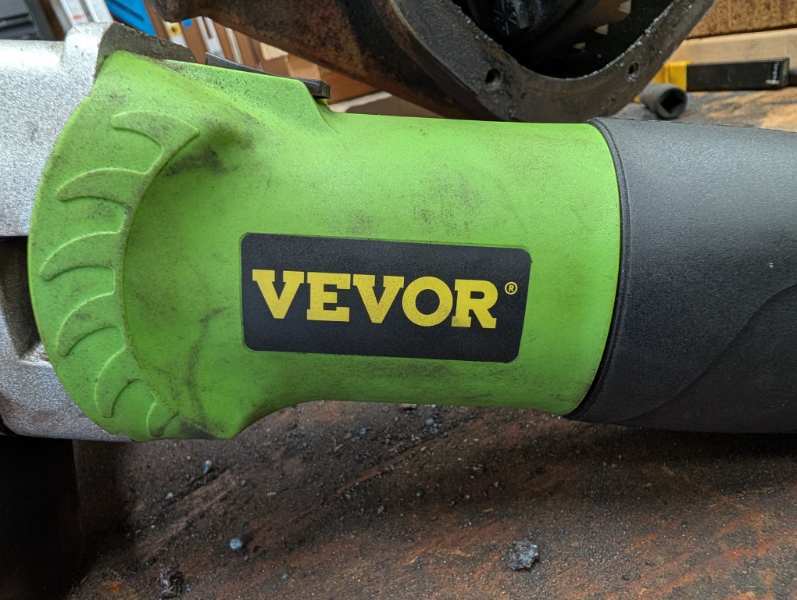

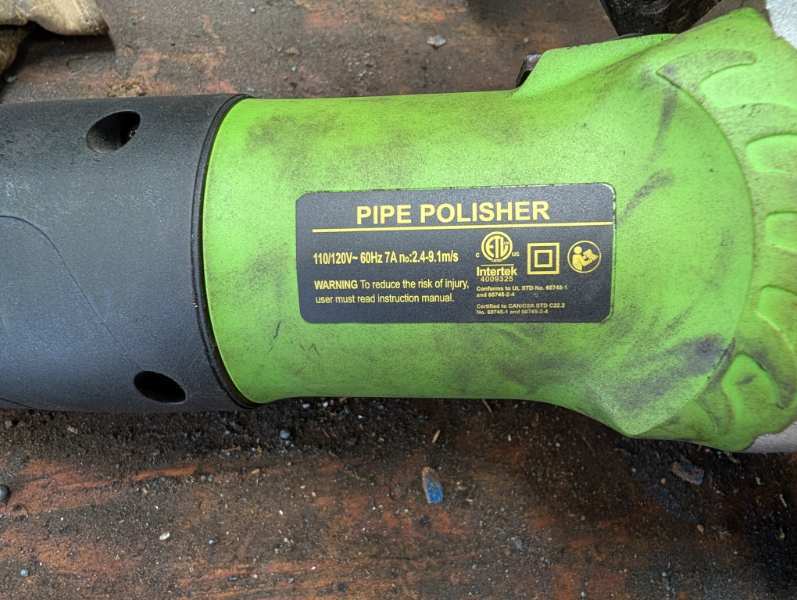

Spent some time polishing my tube.  In full view of the world...
Very handy tool if you have access to one.  This one belongs to a buddy.

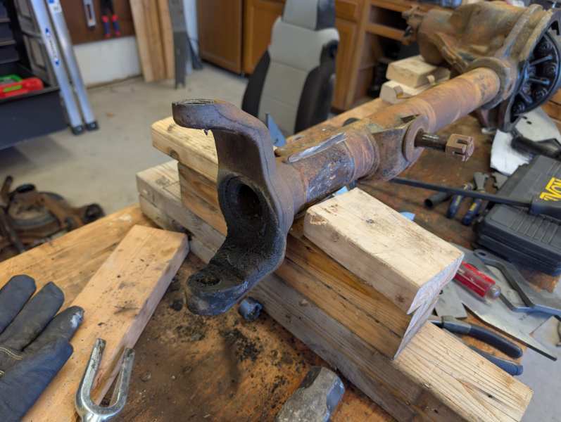

PXL_20261114_210047949.jpg.42d57f191548378ff055b012dbb3cd78.jpgBack to the axle this weekend.  Got the truss basically assembled.  Once it cools down a little, I'll weld it to the axle.
